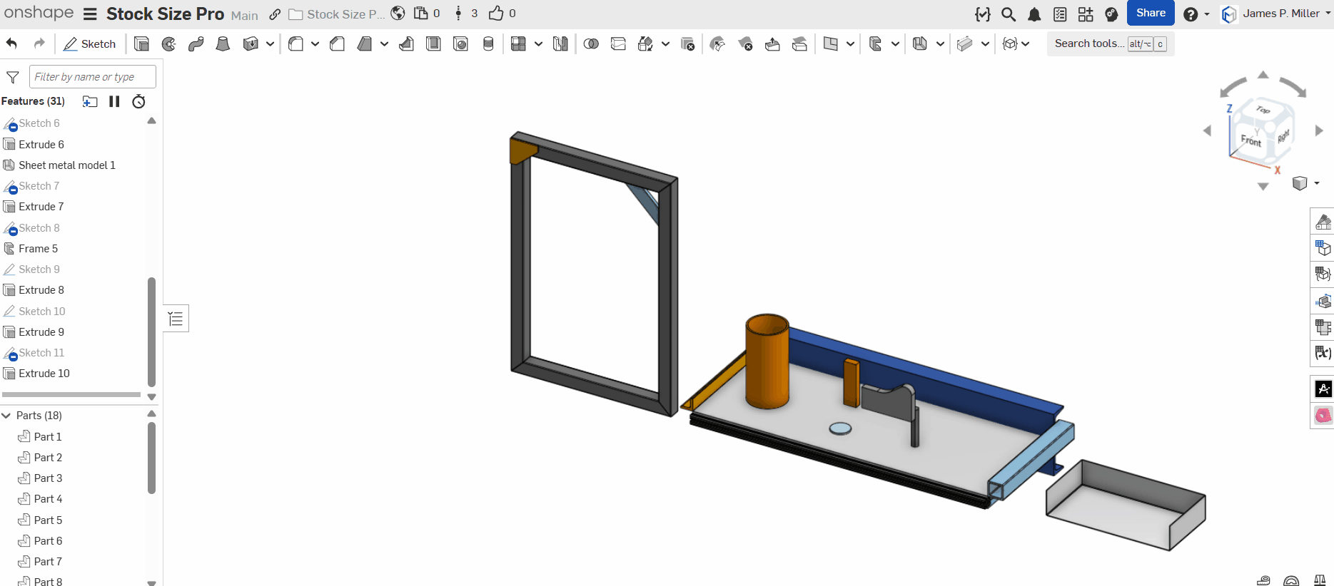

I've created a new custom tool called Stock Size Pro. It basically uses the same stock size calculations I used for my Cut List Pro FeatureScript, but for single parts. This includes: Onshape's Structural Frame profiles, plates, round, tubes, hex, pipe, threaded rod, sheet metal and gussets of several styles.
The sizes can be mapped to a custom property, Title 1, Title 2 or Title 3.

Can you amend this so the units can be selected? At the moment gives all the dimensions in inches, but I'm using mm.
Great tool otherwise
@luke_steele1981 yes. I've been meaning to add a units option. I should have some free time tonight. If not tonight, it'll be within a few days.

Updated Cut List Pro with ability to change units and control rounding.

Hi James,
I didn't get a notification about your reply, but I was just poking around in my document and noticed a pending update to your script. Tried it out and the metric units are working great. Thanks!
-Luke
@luke_steele1981 that's great! Let me know if there's anything else I can implement or improve.
