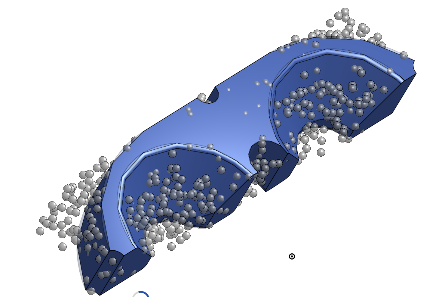

I made an FS that strengthens chosen regions of 3D prints without touching slicer settings, and it does it in the slightly stupid way of filling a region with spherical voids.

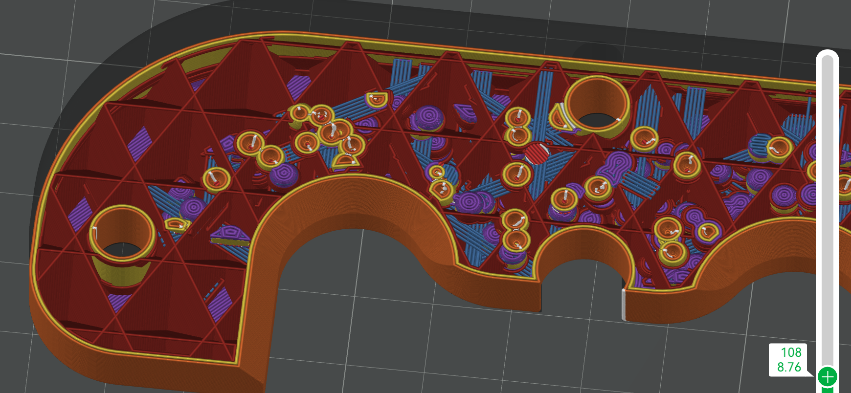

The trick is that slicers put walls around every internal cavity. If you seed a volume with a bunch of bubbles, the slicer puts perimeters all through that volume and you get something close to locally solid infill. This reinforces the part locally, without depending on using slicer settings to force different infill density.

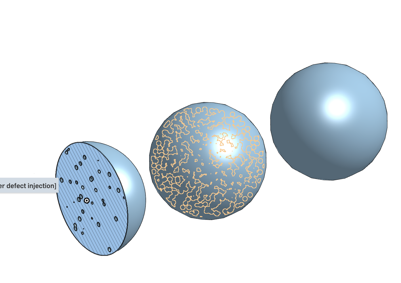

Using it: model a tool body over the region you want reinforced, pick the target part, set a ball radius and a defect density in holes/cm^3 (which is the peak density if using linear/quadratic falloff). Density can be uniform through the region, or decay linearly or quadratically from the center for a strong core that fades out to normal infill. The skin thickness input keeps voids at least that far inside the part's outer surface, so hopefully surface finish and outer walls are untouched. There's a random seed so layouts are reproducible, and a debug checkbox that can show you the balls without cutting anything.
(AI generated text): A note for anyone writing FeatureScript: generating random points sounds trivial and is not. FS numbers are doubles, so the classic C rand() LCG constants silently overflow the 53-bit exact-integer range and your "random" sequence quietly turns to garbage. What finally worked: Numerical Recipes constants (a = 1664525, c = 1013904223, m = 2^32) with the modulo done as x - floor(x/m)*m, which keeps every intermediate below 2^53 and exact in doubles. If your feature needs randomness, steal that.

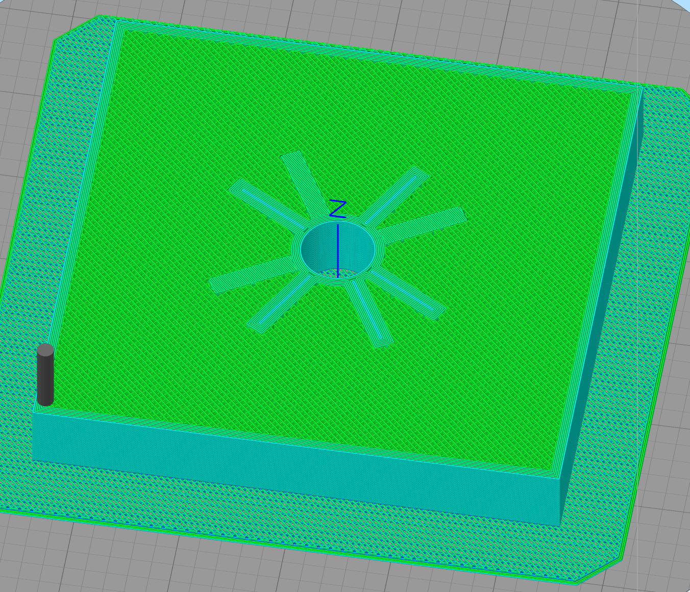

    I've been using "alomost zero thickness" surfaces to create internal reinforcements and can confirm the approach actually works. I do not see the point for the micro spheres, though. They appear a bit too much random to me.

    My "Almost Zero Thickness Surfaces" usually act more like ribs within the infill. Them being almost zero ensures the wall material they provoke will still stick together. A typical case would be to have a set of radial ribs around a load bearing hole.
