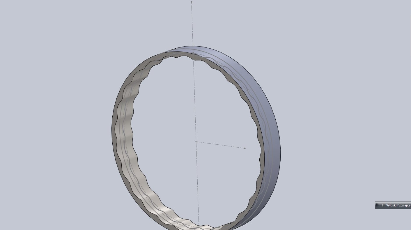

B-Spline ?
how i can pls this part in onship make ?

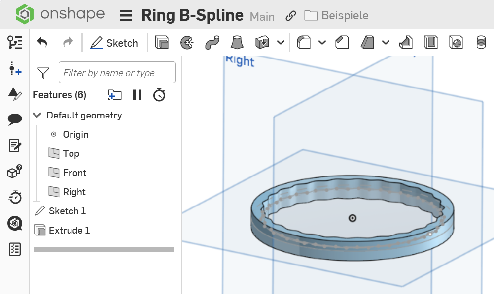

Sketch one segment with whatever you want for those ridges (circular arcs, splines, etc.), extrude, then do a circular part pattern. (The approach maps directly onto FeatureScript, though you'd probably just sketch the whole thing without bothering with the circular pattern.)
Three-minute mockup: https://cad.onshape.com/documents/205f4e0c475d798ec0d521af/w/ca89f94deb70017df5c91f12/e/9de438dc7cb9d33a4def9a02
You could try lik this:
