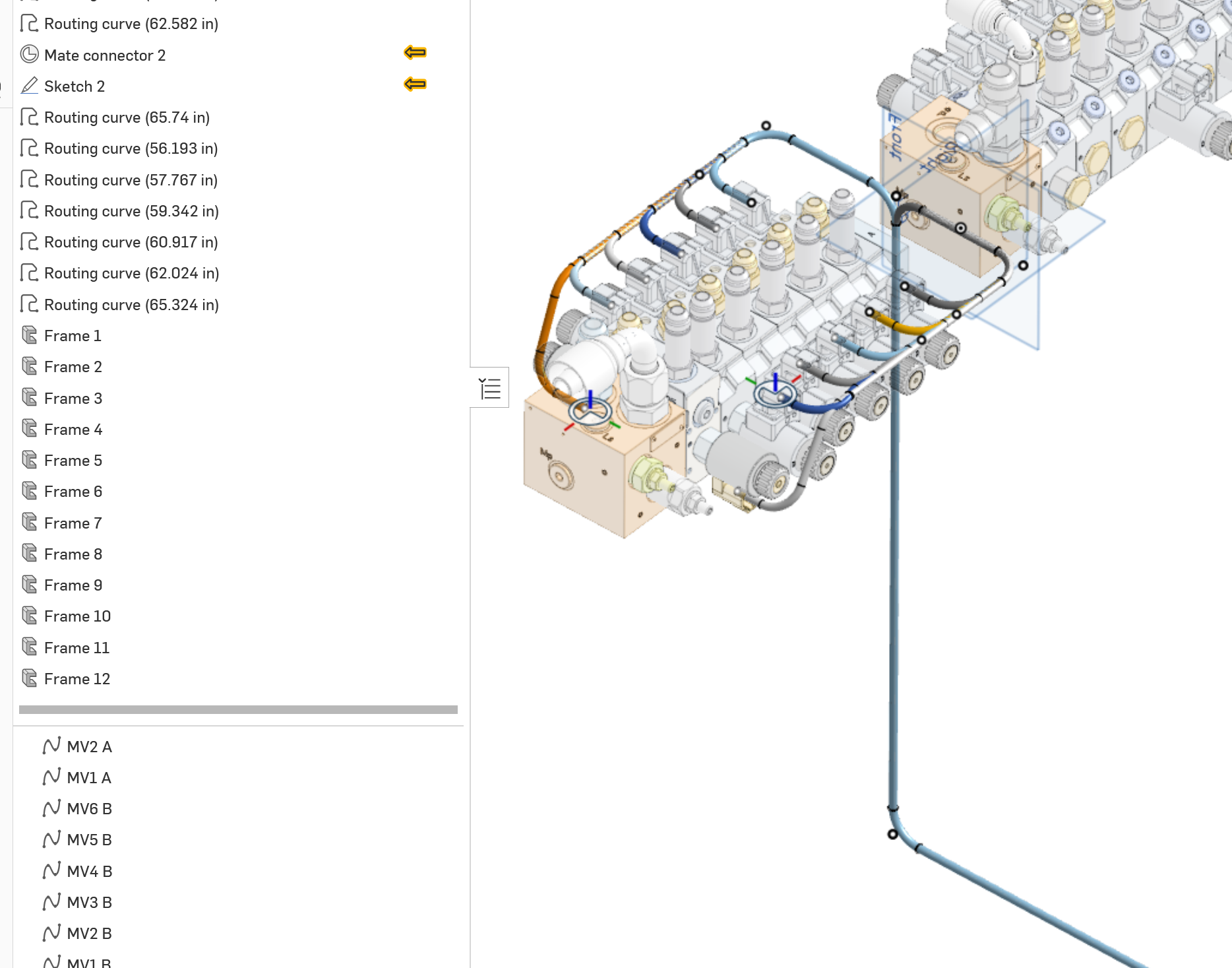

I figured out how to do Routing Curve and it was perfect.
Was able to quickly create routes that connected multiple Items and routed the same path every time.
The trick is to start with the short wire path first. Fast, clean, just what was need.

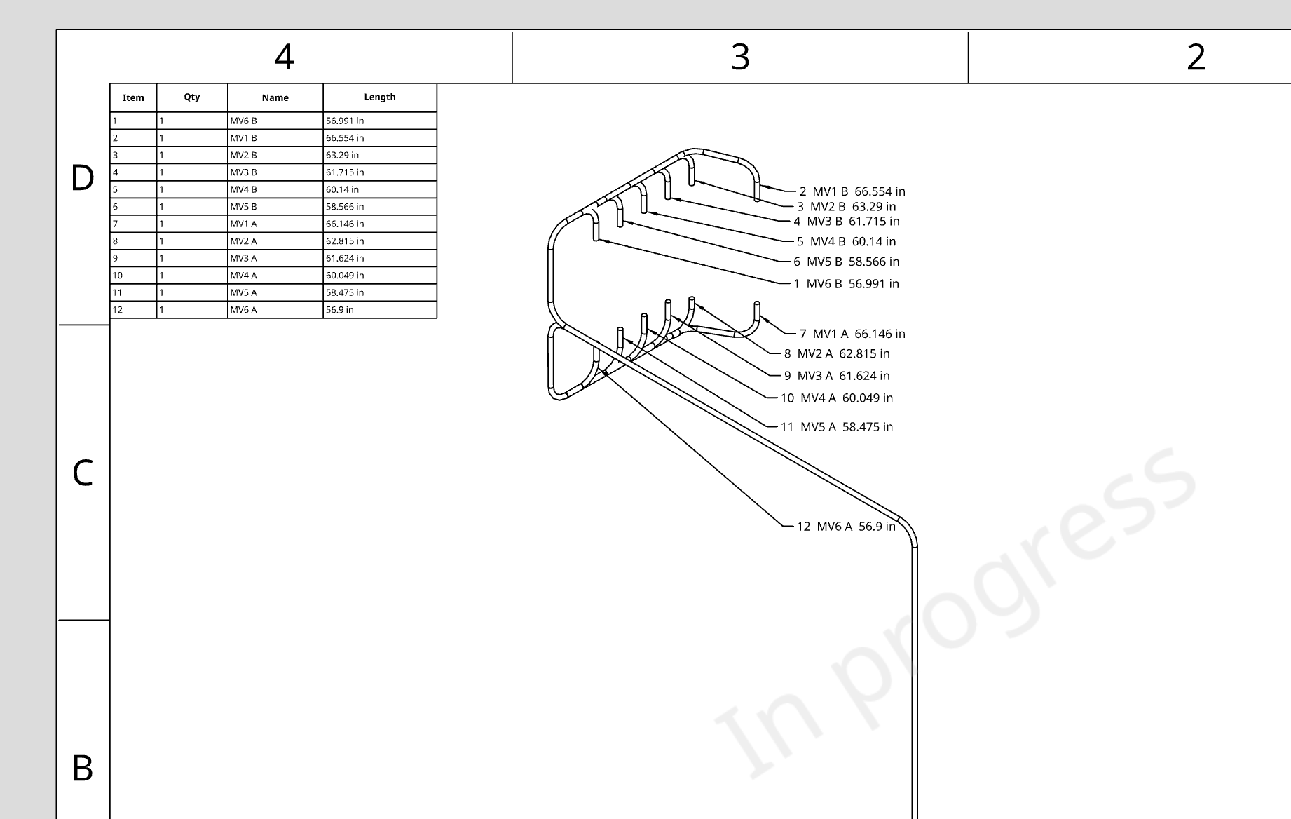

I have found no way to get the length of each route communicated in a print.

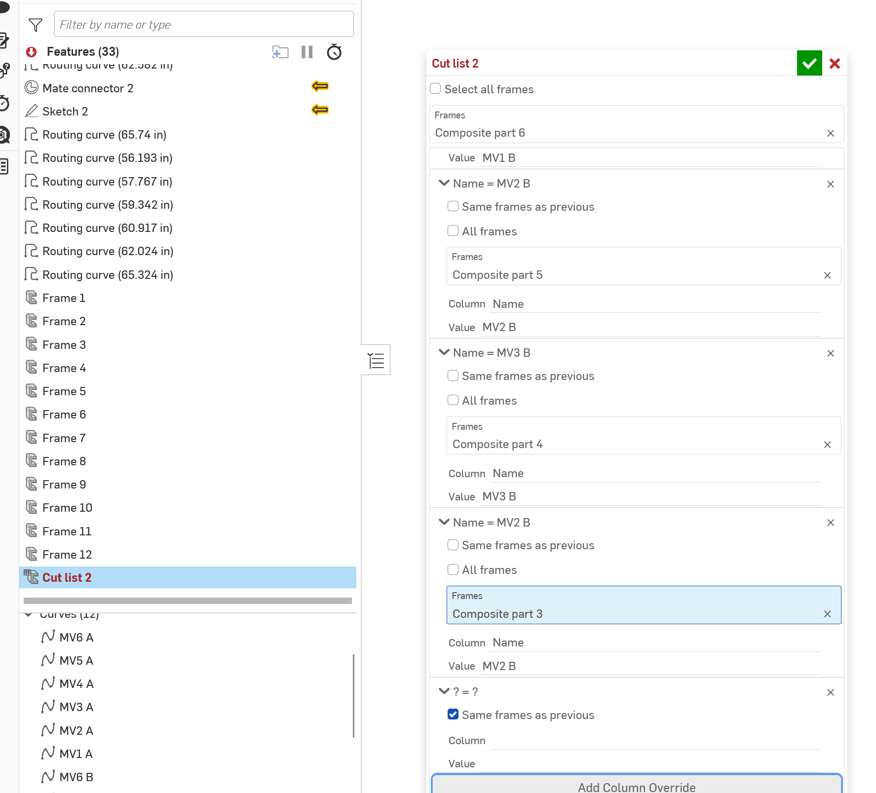

I even used Frame and and Frame Table, which allowed me the ability to place a balloon marker with the Item, and length, but to get an identifier on each cable set, you must add a column and then add and individual name one at a time.

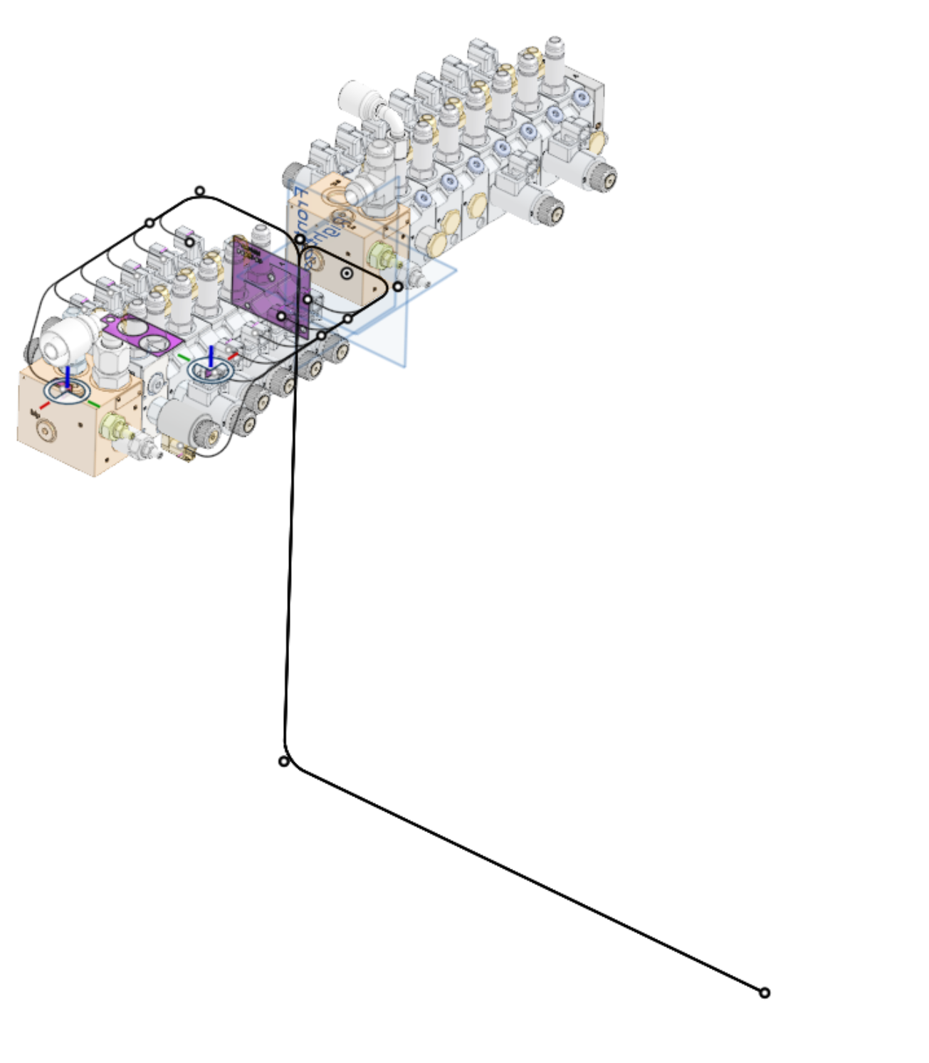

Here is the Routing Created as a Frame Part.
Note the Frame did not capture the defined name of the Curve. This will be another 12 steps to rename every Frame.
Also, See the Length of the Curves in the original creation.
Now all I need is to be able to point to the feature in the drawing with a balloon and provide the Item #, the name of the Curve, and the length.
Next I will create the Frame Table. Is there a better way?
The process of adding ID tags is laborious - 11 motion events - Prone to Errors, which did occur.
And finally a print output.
I have an old Wire custom feature that is way less full-featured than Neil's outstanding toolset, but it does produce a single table with lengths, which sounds like what you're after.
