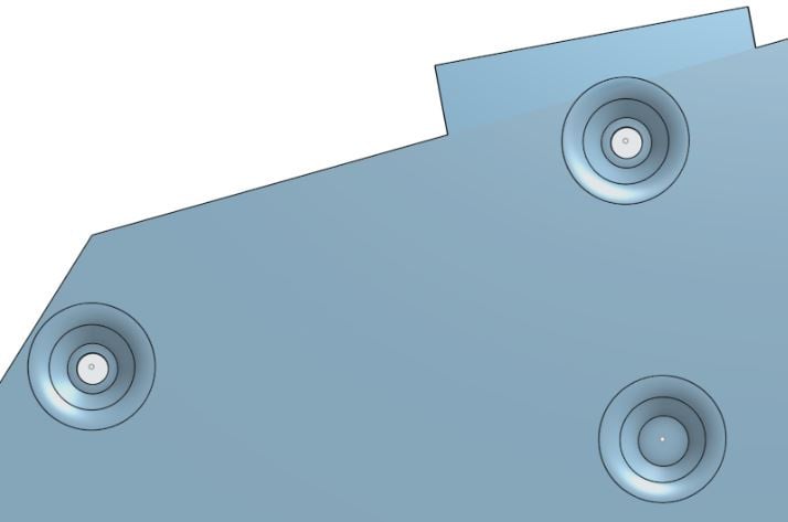

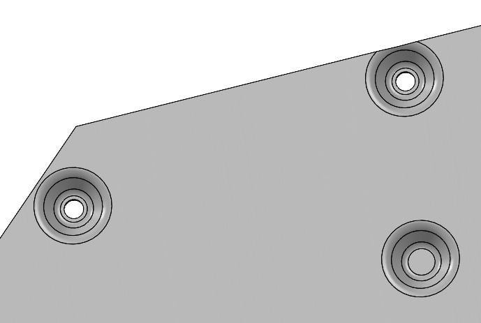

I have to transfer a sheet metal part from SolidWorks to Onshape.
The part has several embosses, some of them cut by the edge of the part.
In SolidWorks there is no real problem - it adds material beyond the edge when you add the embossment, you cut it off afterwards - problem solved.
SolidWorks:
Working with Onshape, no matter what I try, nothing works…
If I try to add the embossment like in the first picture, the embossments that cut the edge aren´t added at all, you get errors shown etc.
If I add material, so that the embosses don´t cut the edge, I can add them, no problem.
But if I cut this material off afterwards, the embosses are removed and are shown as errors, doesn´t work either.
Onshape:
I´m used to having to use workarounds to make things work in Onshape, but this time I don´t know what to try in addition to get a part that looks like it should and leads to a correct flat pattern.
I suppose you can make special embosses only for this part or something like that, but that can´t be a serious solution, wasting too much time.
Can anyone help?

    I believe this is a hard limitation with the tool registration functions in the engine that disallow form features to extend past the sheet boundaries of a given sheet metal surface body. I've experimented with trying to modify the form tool to work on non-planar faces and across bends but all of these attempts were unsuccessful. @lana would know best though.
  • lana
    That is indeed a current limitation of sheet metal Form feature . You can remove the extra material after Finish sheet metal - then it is all baked into 3d, but it will remain in flat pattern.

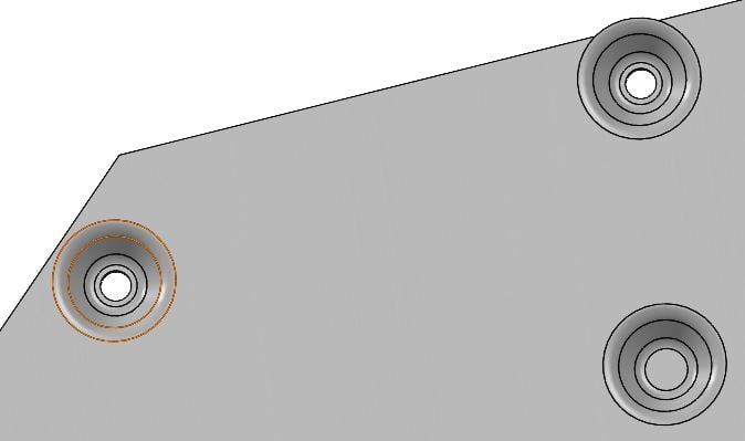

  • oliver_august
    oliver_august Member, pcbaevp Posts: 32 PRO
    Yes, making the 3D model work is not a real problem, that works comparably good as in SolidWorks.
    But we also need a DXF to manufacture the part.
    As we obviously have to deal with this flaw indefinitely we tried to find a workaround for the DXF.
    It´s too time-consuming and hand-knitted for my liking, but it works.
    Beginnig at the very start, first you have to add enough material to make the embossment work at all:
    Then you can do the forming of the sheet metal:
    After that you can finish the sheet metal part (that´s a sheet metal feature) and cut off the surplus material like you would do in any other part studio:
    Btw: Just look for the red points in the following images!
    Now you generate a DXF from the flat pattern of this sheet metal part.
    Of course this flat pattern isn´t correct, that´s what we´re talking about here:
    Choose what should be included in this DXF:
    Now yout get the DXF with the unwanted bulges:
