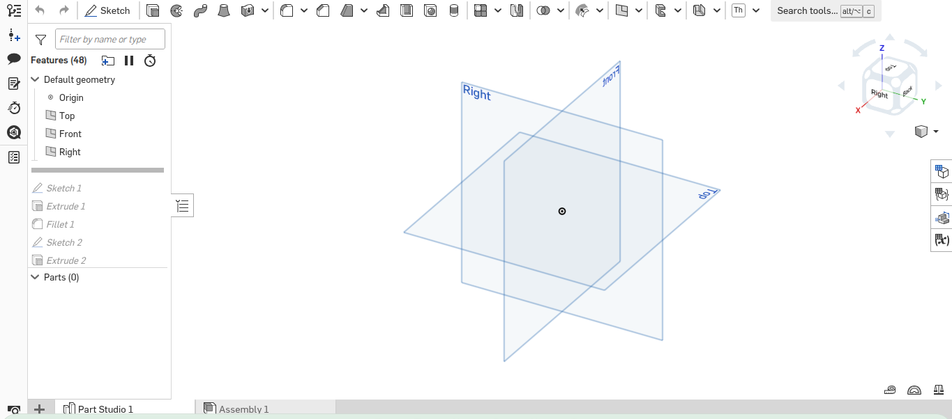

    This is all that shows up whenever I open up my program now. Initially before it crashed , the program spent a while attempting to load the graphics after I did multiple copy and paste extrusions. If there's any another advice you have, I would greatly appreciate it.

    Do you have a link to your document? Someone else trying to open it would help to eliminate local issues. Could it be your copy-paste actions created a loop of doom that runs or reloads forever? In that case: Could you go back one version in the history tree?
    S1mon Member Posts: 4,636 PRO
    At the risk of stating the obvious, it looks like you have your feature tree rolled back. Roll to the end and all the geometry will appear.

    Isn't this a feature added fairly recently where if a document doesn't load anymore (after adding a feature that times out), it will try to roll back in order to load (as opposed to requiring the user to "restore" manually, or open a version)?
    I would hope there would be some sort of warning/message letting the user know this happened though, otherwise I might be a bit confused to see a model rolled back to the start if I didn't leave it that way…
  • lana
    @eric_pesty those recovery options are offered to the user, but he has to choose one in order for something to happen.
