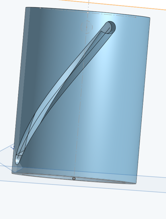

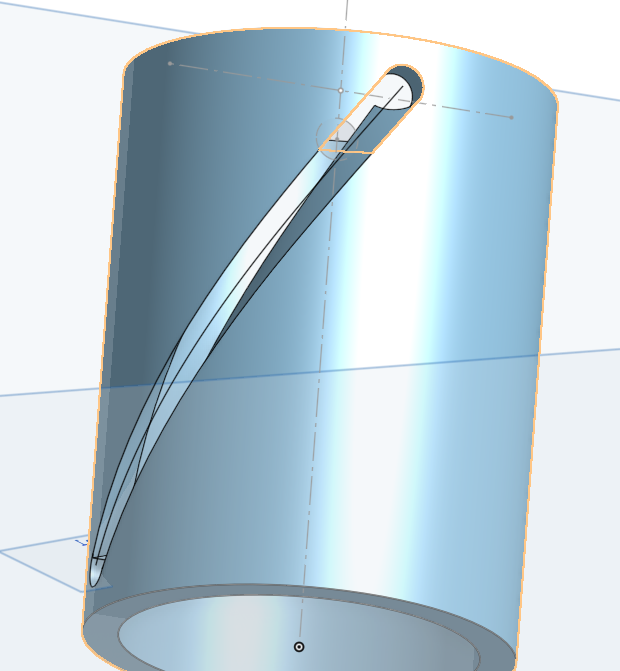

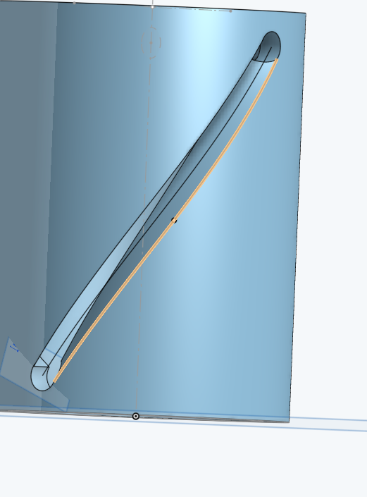

Having some issues with my slot on my cylinder and making my hilux right to extrude the slot. looking for some guidance on this. You can see how its not matching my circles on the cylinder. Thanks!

    Hey Mitchel. One method would be to create a plane on the endpoint of the helix and draw a rectangle with the sides having the dimensions of the slot's width and depth. Sweep-Remove the rectangle profile along the helix.
    Here is another method. - Scotty
