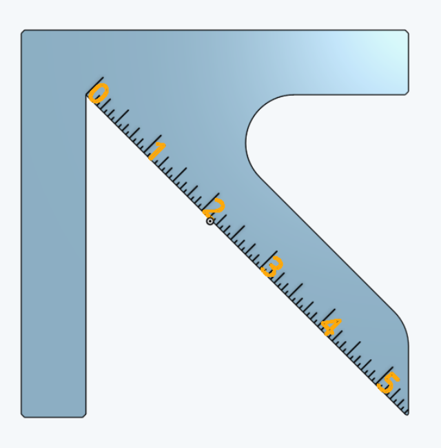

The image below is the bottom of a cylinder center finder I'm using from another Onshape user. I'm trying to modify it to add engraved ruler markings on the diagonal to measure diameter. Anyway, I used a "Ruler" FeatureScript by Gustavo Ambrozio to generate the markings. There are two rulers generated - One for the line markings and the other for the number labels.
I think I successfully have the markings engraved in the model, except for the position of the numbers. You can see them highlighted in the screen capture. I'd like to reposition them so that each number is directly above its long line, but can't see a way to do this.

I can select the engraved number outside of Transform, but once I get to Transform, the selection goes away and I can't reselect. What am I missing?

    Hello Marc. No need to move them. Just draw a line (construction line will do) offset a bit from the line used for the ticks and use that new line for the labels. One Transform tool lives within a sketch edit to move/rotate sketch entities. The other (not while in a sketch) is used to move/rotate a part or parts. - Scotty
