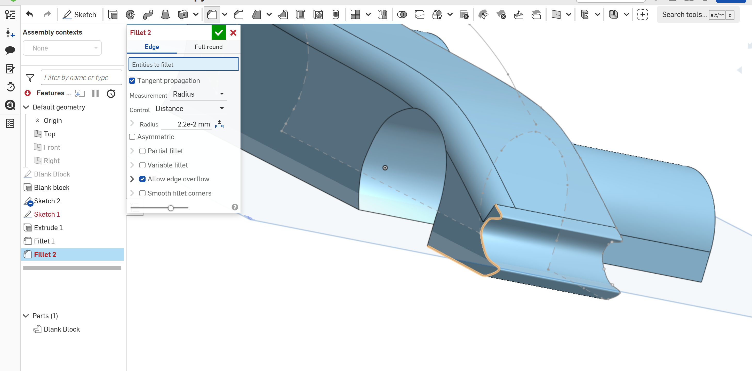

I want the highlighted edge to also be filleted, but the tool does not seem to let me do this. Is there a way around this?

    The end top edge is probably too sharp to allow you to fillet it from the side. The radius would have to be way too small.
    You might be able to sweep a profile along the inner edge of that front face (the curved part of your highlighted area) to cut away some of the edge to form the fillet.

    you can also try rearranging the feature tree so the fillet is before the cut there, the issue is definitely being caused by that sharp turn in the edge path. the other thing you could possibly do is use variable fillets and reduce the radius where the tight turn is but have it be large everywhere else.
