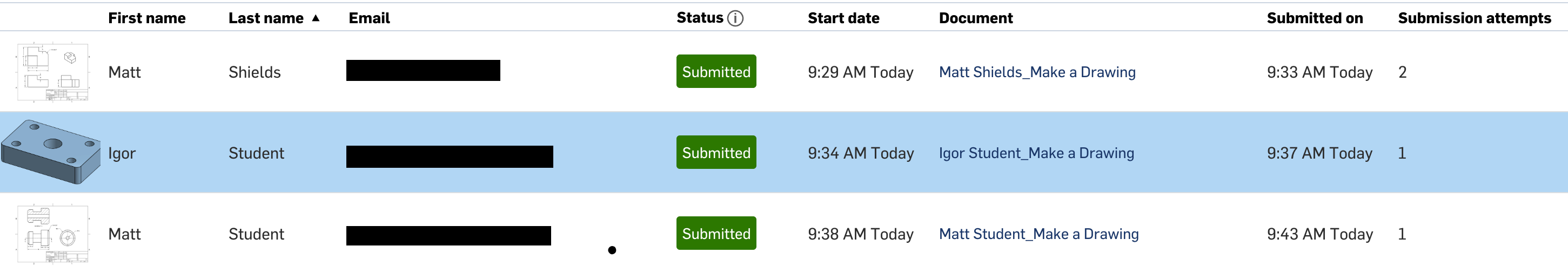

    Using Classes & Assignments, it wouldn't take too many clicks to open each student's document and check out the drawing. There is also the single-source-of-truth benefit where no one is downloading PDFs. And you can leave comments.
    If you really wanted to download drawings in bulk, you could try something like this:
    https://colab.research.google.com/drive/11cP4IviCNqKw1mtuMQ3Q-QYmlA_BvalO?usp=sharing
    Just be aware of your API call limit.
