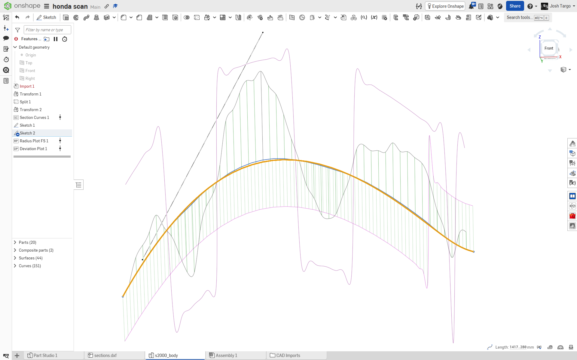

Playing with custom curve tools again
joshtargo
Wrote my own curvature and deviation analysis tools to find better ways to fit clean curves to noisy STL sections. Curvature is the smoother one, Deviation is the wavier one. Max allowed deviation is the square wave. They kinda work, but I would love these to be native with the visualization options I worked into mine.
