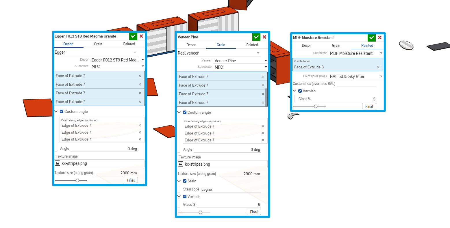

Pick a material, pick each part's visible (decor) face, and click the arrows on the face to turn the grain 90°. It then writes onto the part:
  • An attribute - material, measured thickness, decor face, grain direction and decor-face area. This is what the layout reads.
  • Part properties - Title 1 = thickness, Title 2 = paint code, Title 3 = decor-face area - for drawings and BOMs.
  • Appearance and material, so colors follow the material choice and mass properties come out right.
  • A texture decal on the decor face, aligned to the grain. The image is a manual pick for now - I haven't found a way for FS to choose one per material automatically.
    The grain direction sticks to the face and travels with the part through patterns and transforms, like a decal does.
  • 3 modes: Decor - pick from a list of products, typical for MFC; Grain - pick from a list of grains, select a texture image; Painted - pick a substrate material and define it's color either from a list of RAL tones or paste in a HEX code.

    Update 1.1: bigger library, finishes, custom grain angle
    After some real life testing added some functions I suspected could be useful, but didn't want to bloat the UI at the getgo.
    • Library ~9× bigger: Egger, Kronospan and Pfleiderer decors, 48 veneers, full RAL Classic. Pick a source, click on the dropdown menu and type to search.
    • Decor + substrate: the decor sets the color, the substrate (MFC, MDF, HDF, plywood…) the density. Practice showed it's needed to separate the decor/veneer layer from the substrate.
    • Finishes in Title 2: paint, stain, varnish + gloss %.
    • Custom angle: grain along a chosen edge, plus an angle offset.
    • Textures on Decor too (stone, concrete, metal). Still no way to automatically set the texture image. ;(
    • Dark colors are lightened so parts stay readable.
