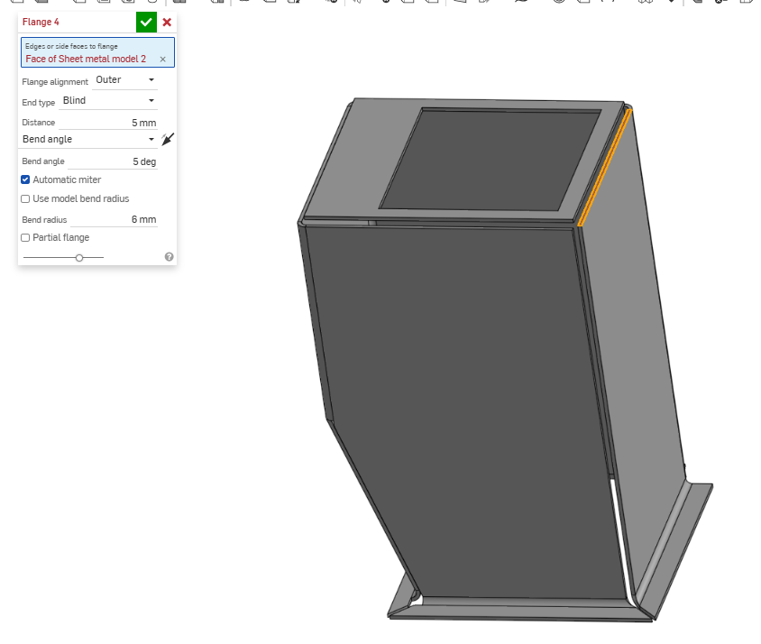

I have a roughly cubic sheet metal model (with no top or bottom) which I have added flanges to the bottom side, but can't add them to the top. I get the error:
"Cannot create flange on an edge that is a joint, fillet, chamfer, or internal to the sheet metal model"
I'm sure I have done one of these things but I cant see any difference between the top and the bottom

    I think the issue was that the top plate (even though it was not attached to the rest of the model), it was still considered part of the sheet metal model and that edge/face was viewed as an internal edge.
    I removed that face (top) from the model and it worked fine.
    Sorry for answering my own question!
