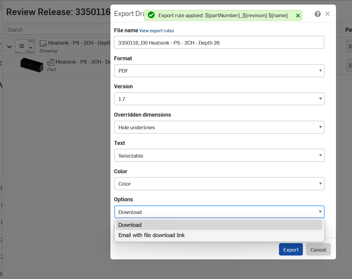

Hi is it possible to get Onshape to export to a SharePoint file? Or have someone made a script for it

    It is possible to have releases automatically export, but you'd need to do this with a custom application that integrates into Onshape using the API.
    Our application Renaissance does have this functionality:
    https://cad.onshape.com/appstore/apps/Utilities/65cea8597fcbf752f335595b
    But it can't go to sharepoint, it can only email you the file.
    But SmartBench Software also offers custom app development.
  • SWB
    SWB Member Posts: 9 PRO
    Hi Caden, yes i know of the mail possibility, if we connect it to Arena it will also export PDF and Step directly to Arena when you release it, but we sort of would like to be able to export it to a folder on SharePoint.

    Downloads go to wherever your web browser is configured to put them. If you want them to go somewhere else, change that setting in your browser.
  • Caden_Armstrong
    Caden_Armstrong Member Posts: 468 PRO
    We've done some custom apps that go to sharepoint
