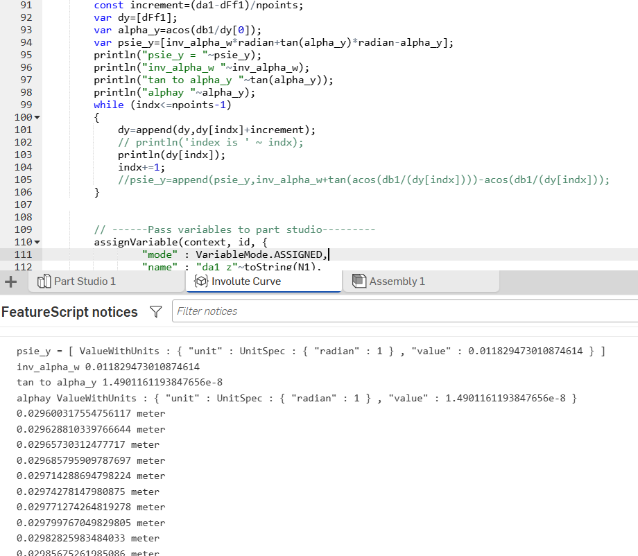

    I'm however still a bit confused about why some things will just print the number and the units while other things will print the whole map. On the screenshot below, I am printing out psie_y which is now a ValueWithUnits (map) after I have multiplied radians to the unitless numbers. On line 103, I am then printing out the value of dy, which is just a diameter but that prints out as just the number and unit. Why do my angles not also just print out as a number and unit?

  • _anton
    _anton Member, Onshape Employees Posts: 554 image
    It's because of the string concatenation - in prepending a string to the ValueWithUnits, it makes println unable to stringify just the value. You can get around it by doing print("psie_y "); println(psie_y);.
