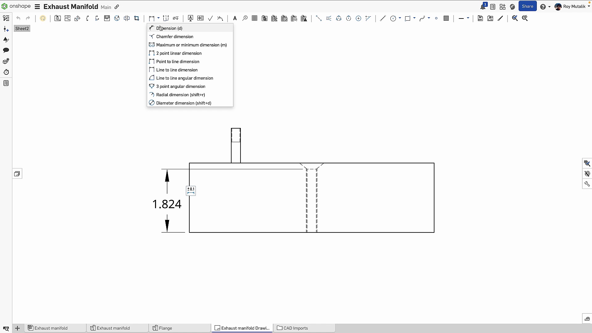

    @Ervin_Kaca We added some support back here on this release:
    d657432c2cd452bfb072287976bb53cc7b99bdb4.jpg?image_play_button_size=2x&image_crop_resized=960x540&image_play_button_rounded=1&image_play_button_color=00890be0
    Improvements to Onshape - March 13th, 2025 — Onshape
    There will be more to come with an option for the hole callout tool to create all dimensions (especially for side profiles of holes) if that is your preference over the note/callout style - but that work is not yet in progress.
