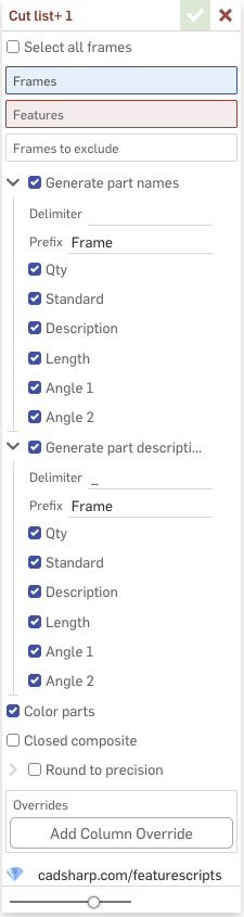

    @S1mon Yes, I haven't officially created a forum post or entry for Cut List+ yet. It's been slowly evolving as different users request more features. There is also a stripped down version of it in the: CADSharp FeatureScript Video Tutorials which shows how to take Onshape's default features and customize them to fit your workflow.
    The "Features" input is so that instead of manually selecting frames, you can select the feature that made them. This is for when you don't need to select all frames in the studio but perhaps a few features that made a group of frames. It appears the Feature list input broke due to some Onshape updates. Strange, those usually don't break things but the feature list input is a little strange.
    Thanks for the input! I think these improvements would be valuable and an easy addition.
    Here's a mysterious hidden update for the Cut List+ feature: 😂
    • Added Unit option for selecting which units to name or describe the parts.
    • Fixed feature list input.
    • Fixed name issue where prefix would only name if Qty name was enabled.
