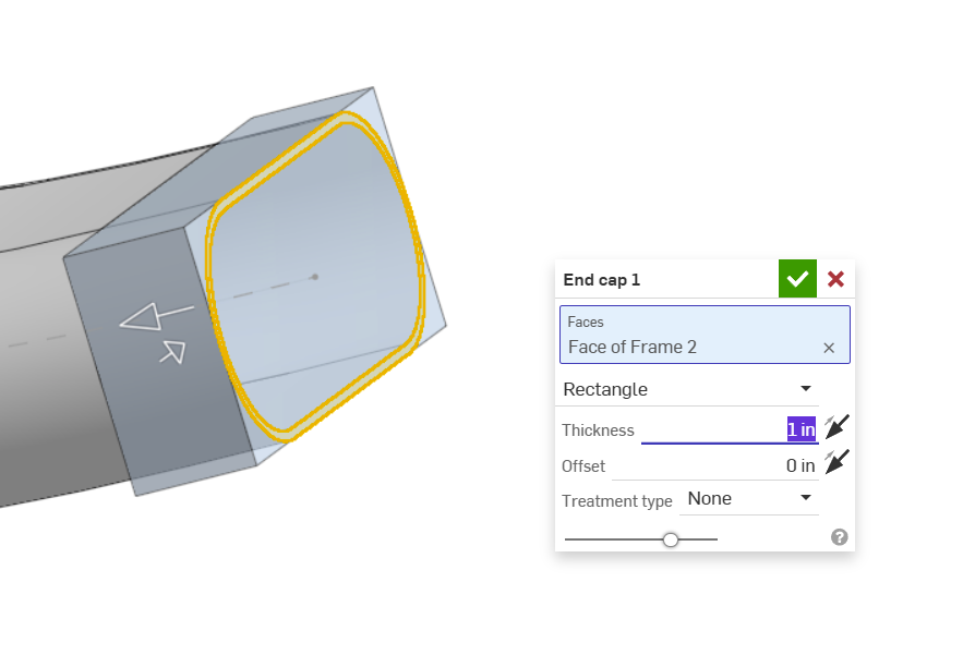

    I noticed what I would consider a bug in Cut List+. Frames supports end caps, but Cut List+ does not. I have a query variable in a part studio which includes all the tubes and end caps. When I use that as the input to Cut List+ it gives an error. If I just use the "All frames" check box it works, but the end caps are not included.

    How would you log the end cap data like the shape and dimensions? This would need the end cap data embedded into it at creation (for easiest implementation).
    S1mon Member Posts: 4,608 PRO
    I'm really not sure what the standard would be for end caps. I'm not a weldment expert, but I assume that the cut list is taking the place of a BOM. I also imagine that when I start adding gussets etc, that those would be in the same table.
    The ones I'm using currently are "match profile", and I'm also matching the thickness with the tube wall thickness. The people cutting the tube to length want the length of the tube, but I care more about the length of the finished weldment with the caps in place.
