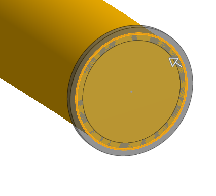

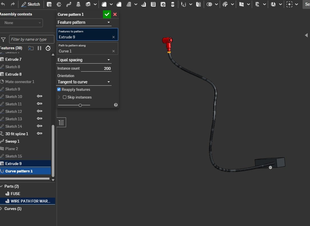

I have used the curve pattern numerous times but t his time the spacing is not equal and I can't figure out why.
  • MDesignMDesign Member Posts: 1,421 PRO
    nm. I was able to replicate. Just adjust your Extrude 9 to make sure it passes inside the surface of the wire. Onshape is not liking having to connect zero thickness geometry or something there.
  • dianne_bali794dianne_bali794 Member Posts: 3 PRO
    Thank you! That took care of it.
  • EvanReeseEvanReese Member, Mentor Posts: 2,967 PRO
    sounds solved, but for the future this is what it looks like when you feature pattern and some of them fail. The feature will re-run Extrude feature, but if it fails, the pattern feature doesn't show an error. It just skips that one and moves on. btw, this looks like a case where patterning the body instead of the features might be better anyway.
