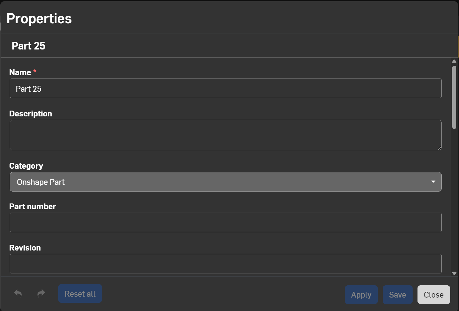

  • Matt_ShieldsMatt_Shields Member, Onshape Employees Posts: 965 PRO
    Right-click the part, select Properties, click Reset All.
  • graham_lockgraham_lock Member Posts: 265 PRO
    Thank you but the Reset all button is disabled?
    Yeah, that's a weird one. Happens to me sometimes, too. I just type something random into the Description, hit Apply, then the Reset button comes back to life.
    That got it!
    Thank you.
