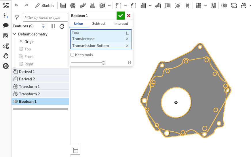

My first time trying this. I have two parts which are essentially flat plates (made from 3D scans of a transmission face and a transfer case face). I initially tried to insert both parts into an assembly and revolute mate them on a common center hole. But my CAM slicer didn't see them as a manifold so wouldn't slice them.
I created a new part studio and created two derived parts from two part studios, transformed them into the correct positions, and then tried a boolean operation to turn them into a manifold (is that the correct terminology?).
My issue is that each part has its own mounting holes but where those mounting holes overlap the other part, they don't "punch through" the union part.
This attached screenshot hopefully conveys what I'm trying to do better than my words. You can see there are a bunch of holes from one part (the transmission face) that are not 'punching through' the second part (the transfer case).
I'm not sure what the correct approach is here. Is there a better way to accomplish this?

    Hello Herb. After the transforms, create a sketch on either exposed face of the two parts, a parallel plane or a mate connector. Using the Use tool, capture all the holes you need. After the Boolean, use the sketch to extrude (remove) the holes in the part created by the Boolean. - Scotty
