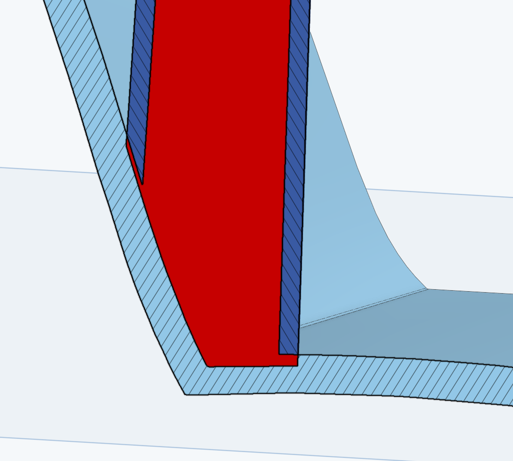

I'm essentially trying to do a chamfer which wraps around a drafted cylinder where the end of the cylinder is based on whatever random shape it runs into and some offsets. Here's a manual version that's almost working using a Face blend. (Fillets, loft and chamfer all fail miserably for these sorts of really steep angles)
I have something that works remarkably well when the walls are fairly normal to the line of draw for molding and the surfaces aren't too crazy.
Here's a preview:
When the wall is really inclined, a boss is close, it's even more important to have a moat to reduce sink on the outside. Here's an example:
Here's a little playground where I've tried various ways to hand build this:
The only way I got something that didn't completely suck or fail, was to split the inputs in half, and use a boundary surface (which won't work with closed profiles). Getting clean edges which can then have fillets added is its own challenge.
Just curving the side wall a bit more makes the intersections a bit more complex. This example was easy to split in half since the boss axis is normal to the extrusion direction of the wall, but a more complex 3D shape will make it harder to generalize the boundaries. I have some ideas, but I'm wondering if I'm missing any. I've also tried using offset curve to see if it created anything that was cleaner, but it's easy to make a mess with really oblique angles like this. I tried using approximation with deg-3 and deg-5, but at least with loft that didn't help.

If chamfer was robust enough, that approach might work. Unfortunately I've run into too many things where it just says no. It also fails miserably to understand what D1 x D2 should do.
Here's looking at the side view with the chamfer:
The two edges of the chamfer are somewhat ok on the lower side of the moat, but as it climbs the side wall, it's useless. If I switch to "offset" measurement I get this:
I've tried using Face blend in chamfer mode with limits, and that's not very robust.

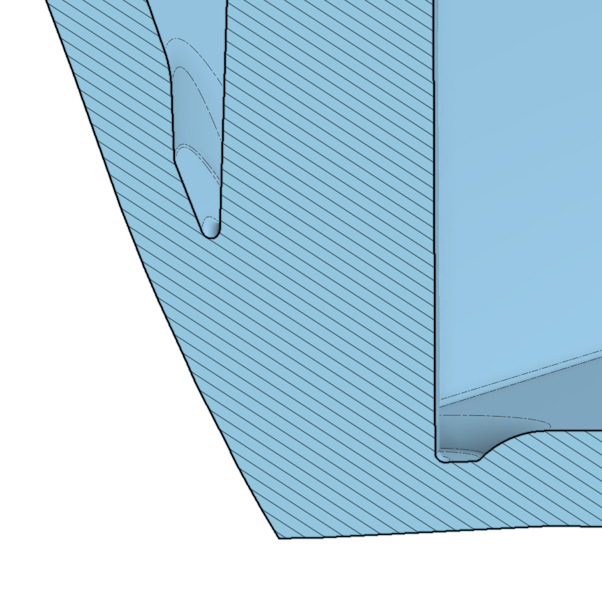

Steep walls are not "suitable", but industrial design and product requirements (overall outside size vs internal packaging) drive all kinds of less than ideal mechanical engineering and moldability situations.
I generally try to avoid the complexity of putting in moats if possible (for ME and tooling simplicity). Sometimes you need them. Sometimes you especially need them because the boss needs to be on an inclined wall. These two bosses (in the section) had to be in a tight area and be connected to some ribs that couldn't be interrupted. The ID was locked a long time before this spin of the ME work. The other bosses had thin enough walls and gusset ribs to keep them more simple.
(this was done in Solidworks)
