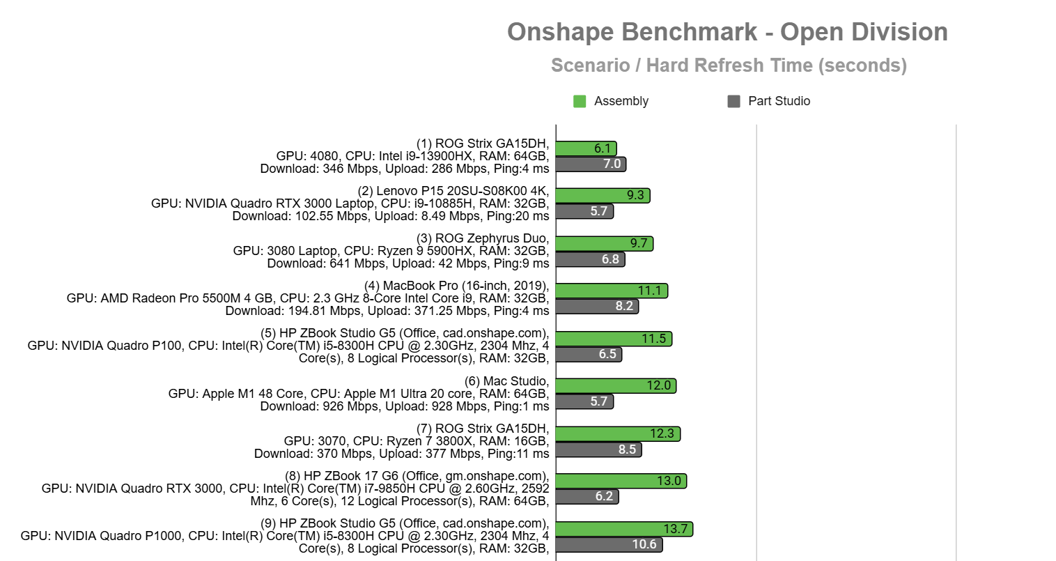

Onshape Benchmark Sheet (UNOFFICIAL)
This is the Unofficial Onshape Benchmark. This was created so that we can compare our systems and see which ones are the very best for Onshape. There are several types of results; the "Open Division" is for everyone to participate in, the "Closed Division" will be strict tests where only one variable is changing at a time in order to obtain pure data. I would love to add more entries to the open division is anyone is willing to participate.
Your benchmark sheet includes a live chart which is linked to the Open Division records.
If you send me your Benchmark sheet, I will add it to the records!
Results
Up to date results for the Open Division can be found here. This will be updated as more records are posted in this discussion.
Open Division - Onshape Benchmark - Results
Closed Division - Onshape Benchmark GPU - Results

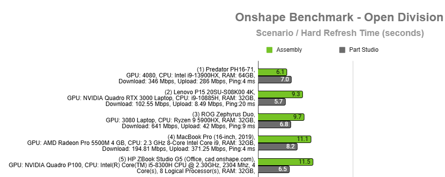

  • MichaelPascoeMichaelPascoe Member Posts: 2,814 PRO
    edited October 2025
    We have a new leader for the assembly benchmark time open division.
    Surprisingly, part studio benchmark time was worse for this device than the previous leader.
