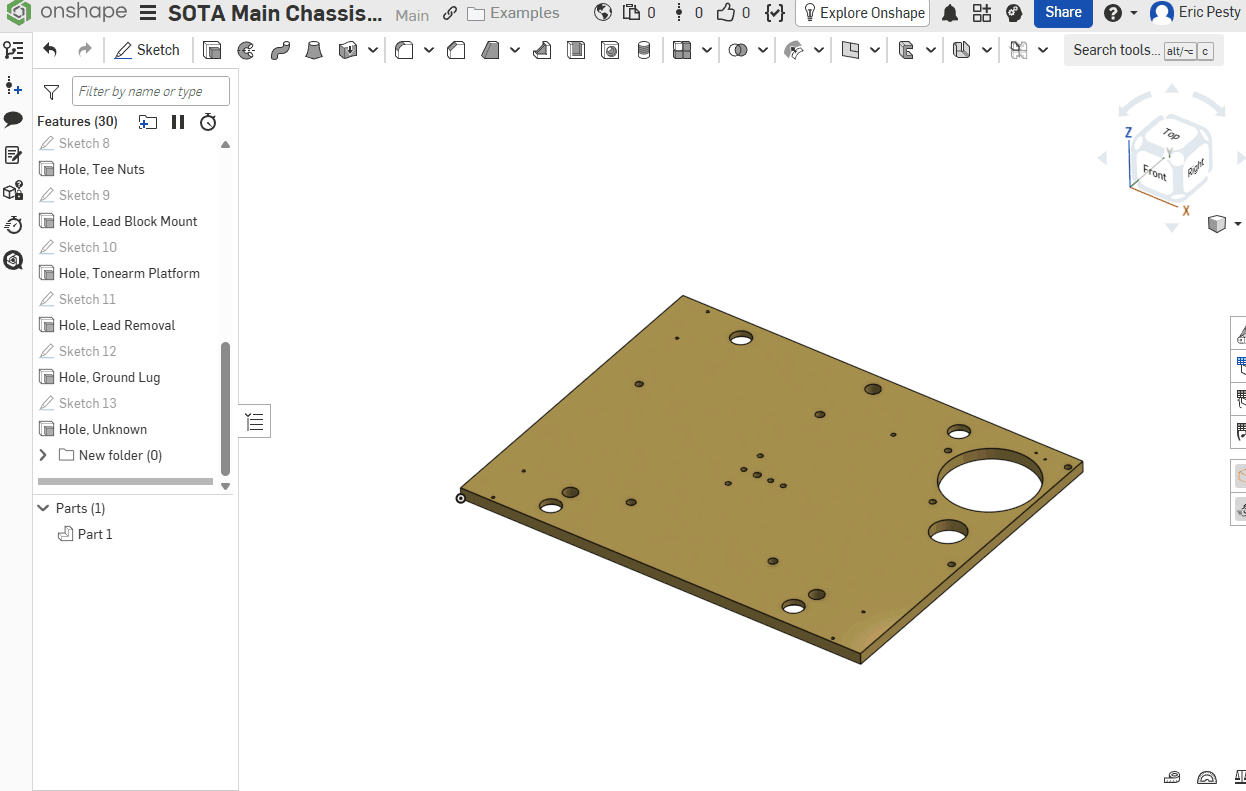

Re: New Dude Having Problems with Copying Parts
Noticed you are using the free plan so had a look…
Here's how you can create the Lead sheet part in 40s by using the same part studio as your main chassis:
I would also recommend using the "hole wizard" tool for screw clearance holes etc…
Was going to say as well: these should all be in the same "document", and the plates that share the same holes should either be configurations of the same part of parts created in the same part studio!
"Copy workspace" is going to be a very inefficient way to do this but if you wanted to make it work, inserting parts from a different document requires creating a version so I am guessing you didn't do that after the "copy workspace" and making the changes (so you are only able to insert the part as it was immediately after the "copy workspace" operation.
The blocks also look very similar and could likely just be configurations of a single part…
A bit overkill for the "level" of your project but this is a good one to watch for project organization, especially if you plan on doing more complex thins in Onshape:
https://www.youtube.com/watch?v=pIjq6S8TUME
