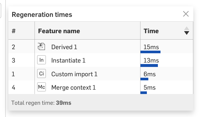

Re: Multiple derives not allowed?
Funny workaround:
- Go to the part you want to derive twice.
- Go to configuration, and add a new dummy configuration variable. (I made it a text type, but I suspect anything works.)
- You don't have to actually use the variable anywhere :D
- Derive the same part and config twice, except that you give a different value to this new dummy variable.
- You now have two identical parts, but this weird check of disallowing the same config twice thinks the parts are different because of the dummy config variable
I have no clue why this is a limitation. It is definitely not performance:
- I don't see why importing the same config twice is more expensive than importing two different but similar configs
- This can even be an optimization: they have proven to be able to detect duplicate configs, and they can just copy the previously derived part, instead of generating the same config twice
Maybe something weird can happen sometimes if you derive the exact same shape twice. But if so, then this error check fails to prevent that, given the dummy variable trick works.
Does anyone know why this is a limitation, or can the devs just remove this limitation maybe?
