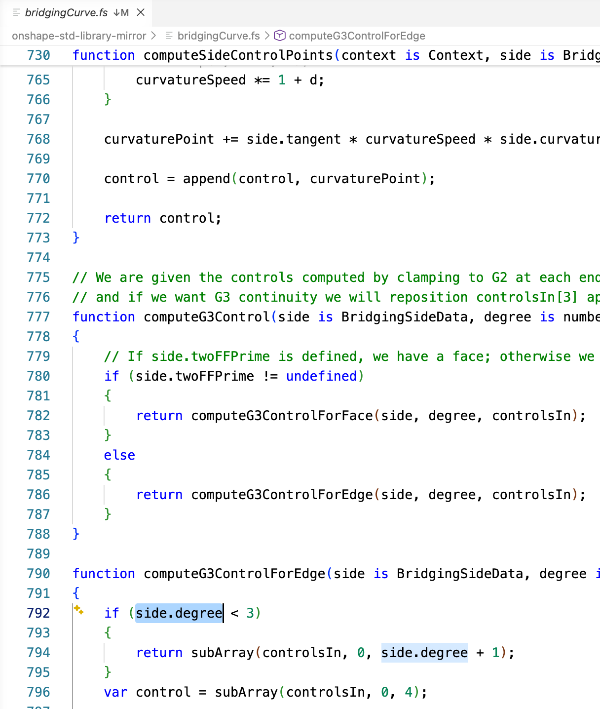

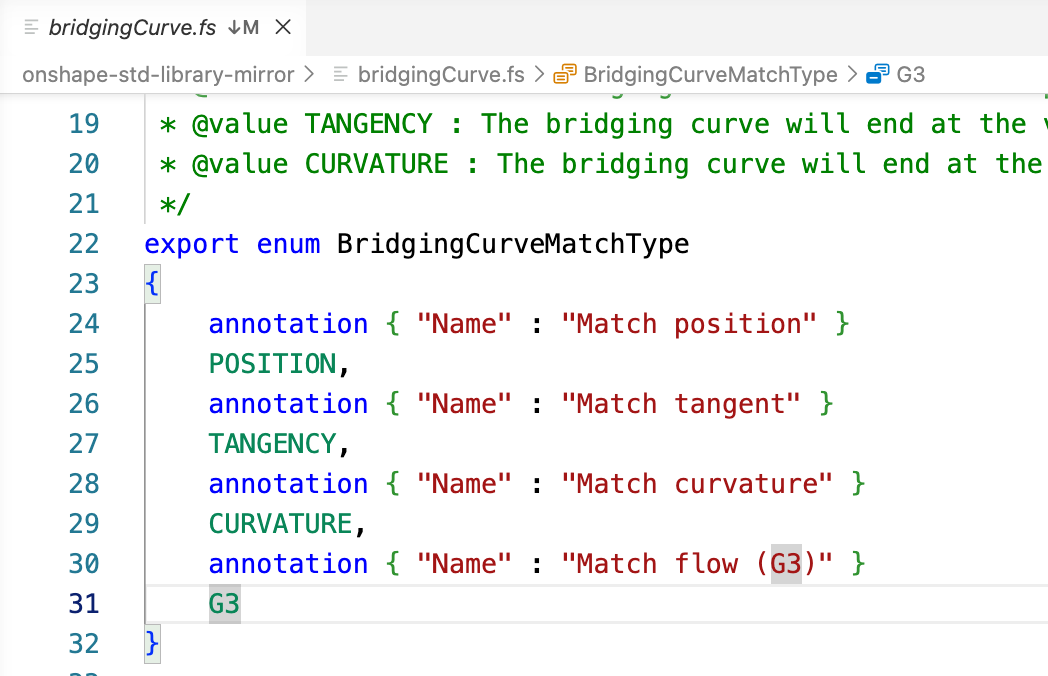

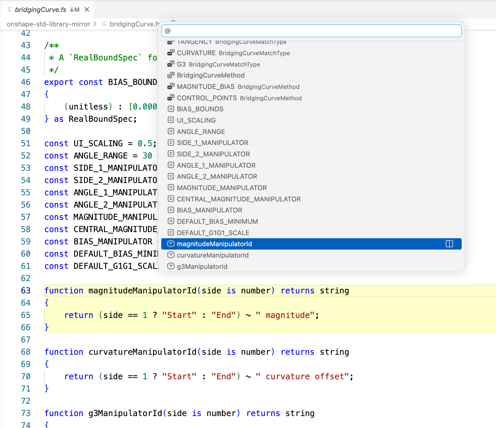

I'm honestly still learning the basics of VSCode, but one of the nice benefits of this FeatureScript aware plugin is that you can navigate by symbols defined in the text (editor or workspace).
Shift Cmd 0 (for workspace) brings up this menu which is the list of enum, const, function, export, etc.
The text below the filename also gives you breadcrumbs of where you are in the file.

This is interesting indeed, if the api integration through public extension will be added together with agentic coding this can boost productivity extensively. Great work, thanks for sharing Simon!

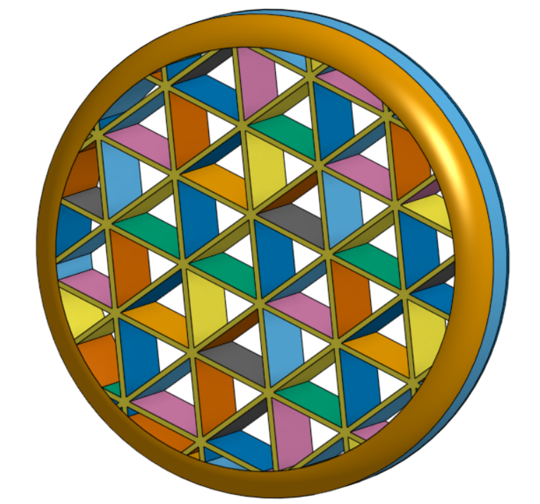

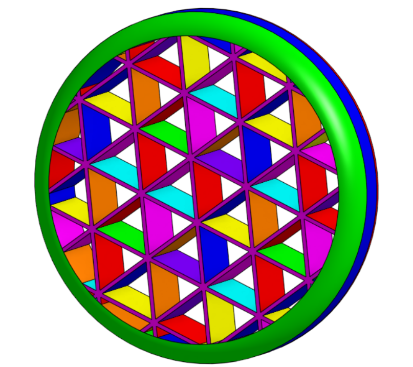

Re: Rainbow Faces Custom Feature
Finally got a nudge to take another look at this, I've added a high contrast mode and a red/green colour blind mode.

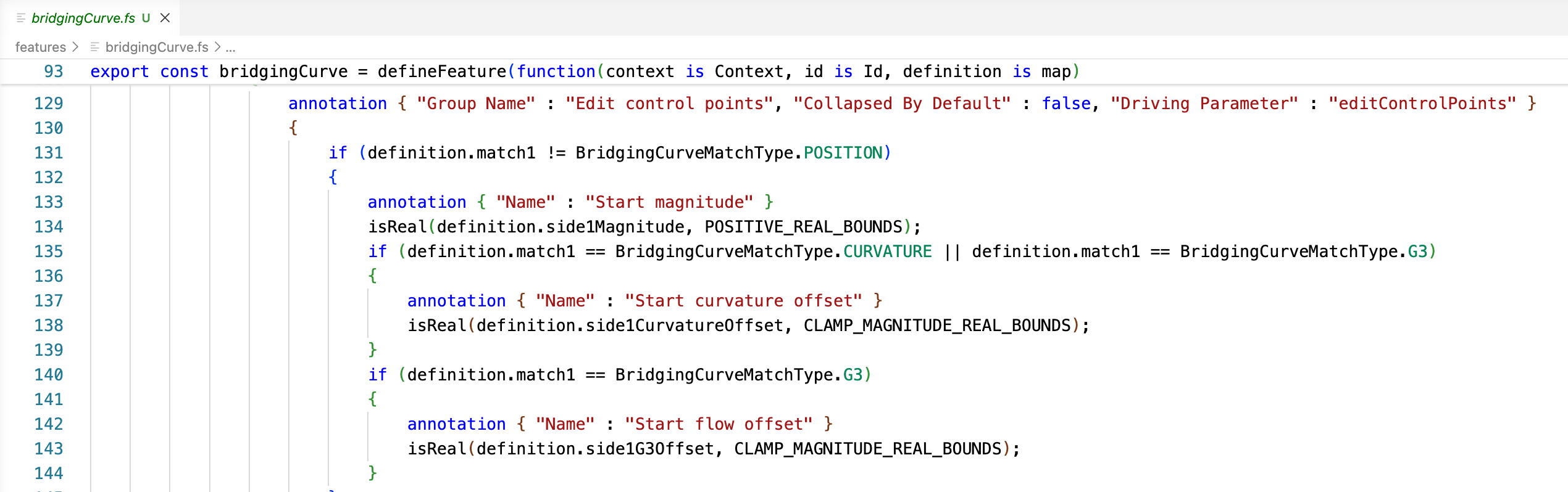

Adding FeatureScript Syntax Support to VSCode
I do a lot of vibe coding of FeatureScript using Codex and VSCode. I've wanted better FeatureScript syntax highlighting support for VSCode. Codex and ChatGPT developed a .VSIX extension which you can install. It knows the syntax and standard library and it will use sticky scrolling to show headers of functions and other blocks while you scroll.
https://github.com/gatrall/featurescript-language-support
Please follow up here with bug reports or improvement requests.
