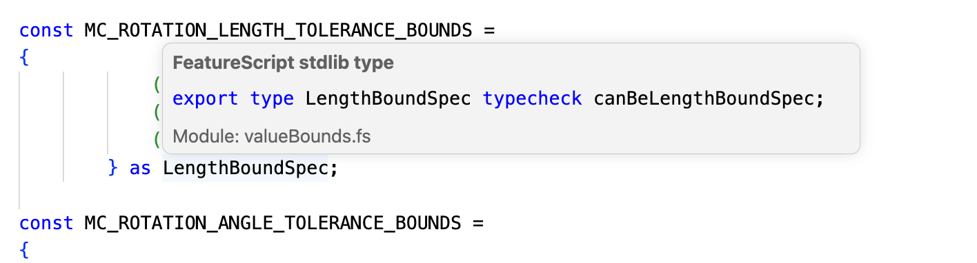

  • Konst_Sh
    Are the "go to definition" and "where used" capabilities not there yet or I'm doing something wrong? Also would be good to have tooltips from symbol docstrings
    S1mon Member Posts: 4,588 PRO
    Apparently I just needed to ask it to do that too. 0.1.5 version is up on GitHub.
    This works within the file. Adding workspace references will be a next step.

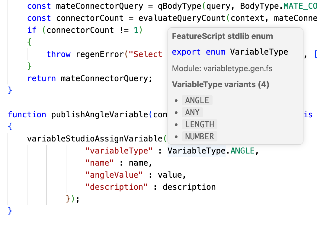

  • Konst_Sh
    edited May 1
    Works great, thanks! One suggestion - I find the tooltips for enum types that show the full list of variants available in onshape feature studio more useful then how it currently only shows the symbol name and docstring. Also I'm curious what it takes to make autocomplete work for enums and maps? I know the autocomplete is basically all-ai now, but making it more autonomous wouldn't hurt.
    Another thing which bugs me often in onshape editor is that we have a bunch of features like frame(), extrude(), enclose() with no definitition fields documented via docstring, which makes fields auto-complete when typing function call not supported, though this fields info is clearly available in predicate
    I put your comment into Codex verbatim
    It came back with a plan and I approved and it just did it.
    See GitHub for the latest 0.1.6 release.

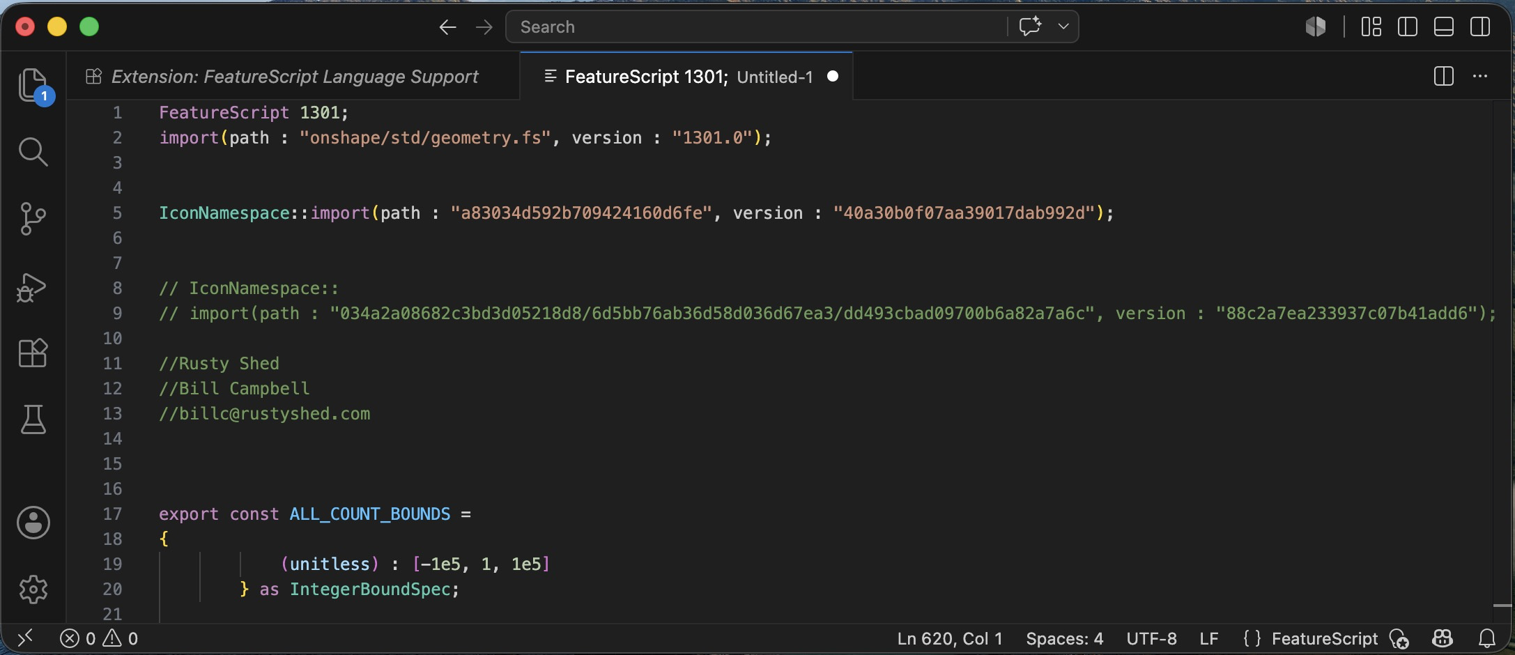

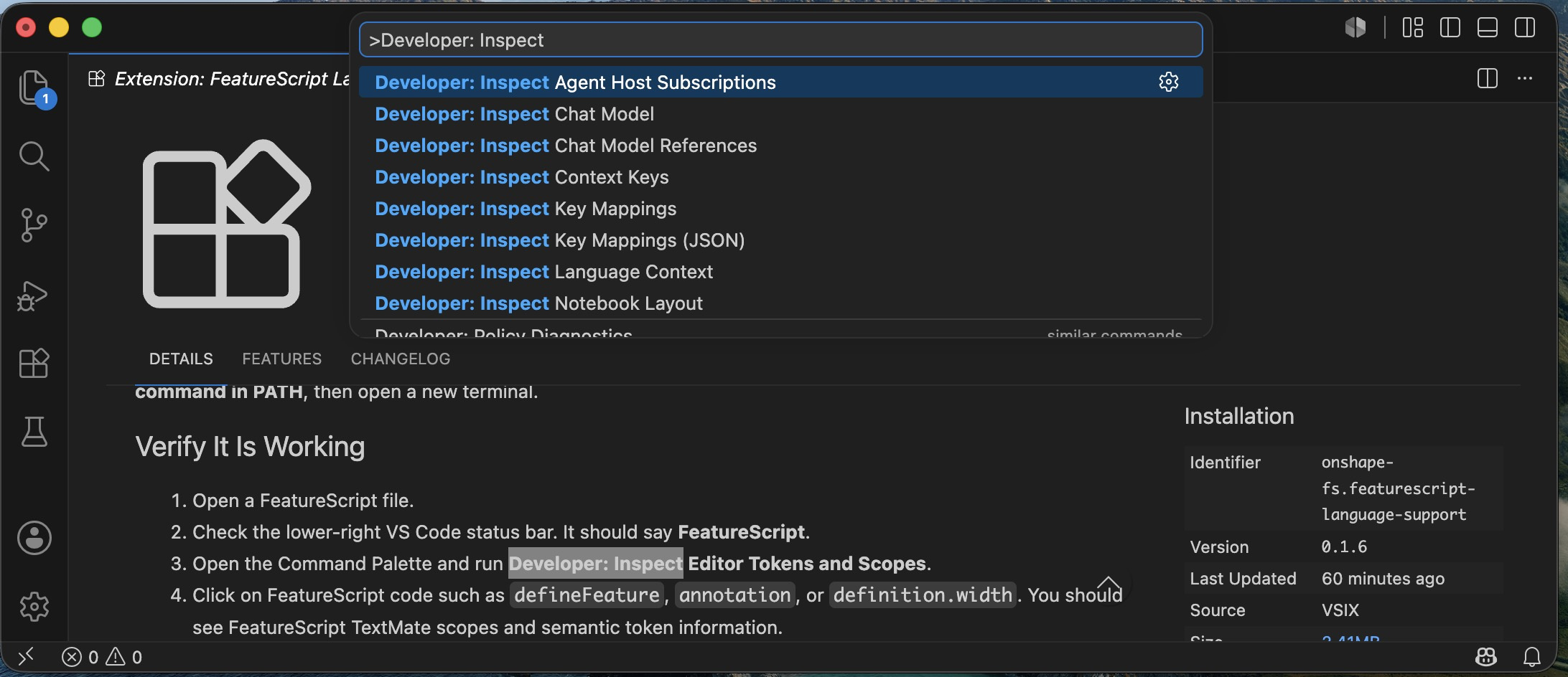

  • billy2
    I got syntax checking working but nothing else
    Screenshot 2026-06-24 at 3.53.40 PM.jpg Screenshot 2026-06-24 at 3.52.45 PM.jpg
    edited June 24
    @billy2 Hmmm. I assume this is the latest version of VSCode?
    If you mouse over things do you get tips like this:
