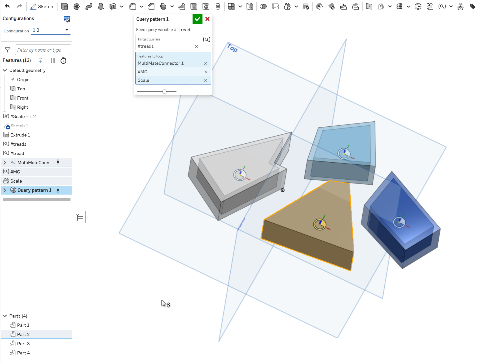

Re: 🚨 Custom Feature Alert 🚨 Query Pattern
Watching your video again makes more sense, I must have had a fried brain at the end of work yesterday. I realized digging into it that I didn't need to query a face after the body selection but could jump straight to the body. I think that extra layer was getting me twisted around. Thanks for the help, this is such a cool feature!
Yeah always a risk but I went there haha! Essentially you need to find a way to query the face for the scale MC as it relates to the input query and nothing else. In your case the input is the sketch face that creates the extrude and everything else. Here's an example.
https://cad.onshape.com/documents/654daad06368d6696966fd46/w/40f1fd8817196e3d87f661e3/e/7b4ba41a5585441160393dc0

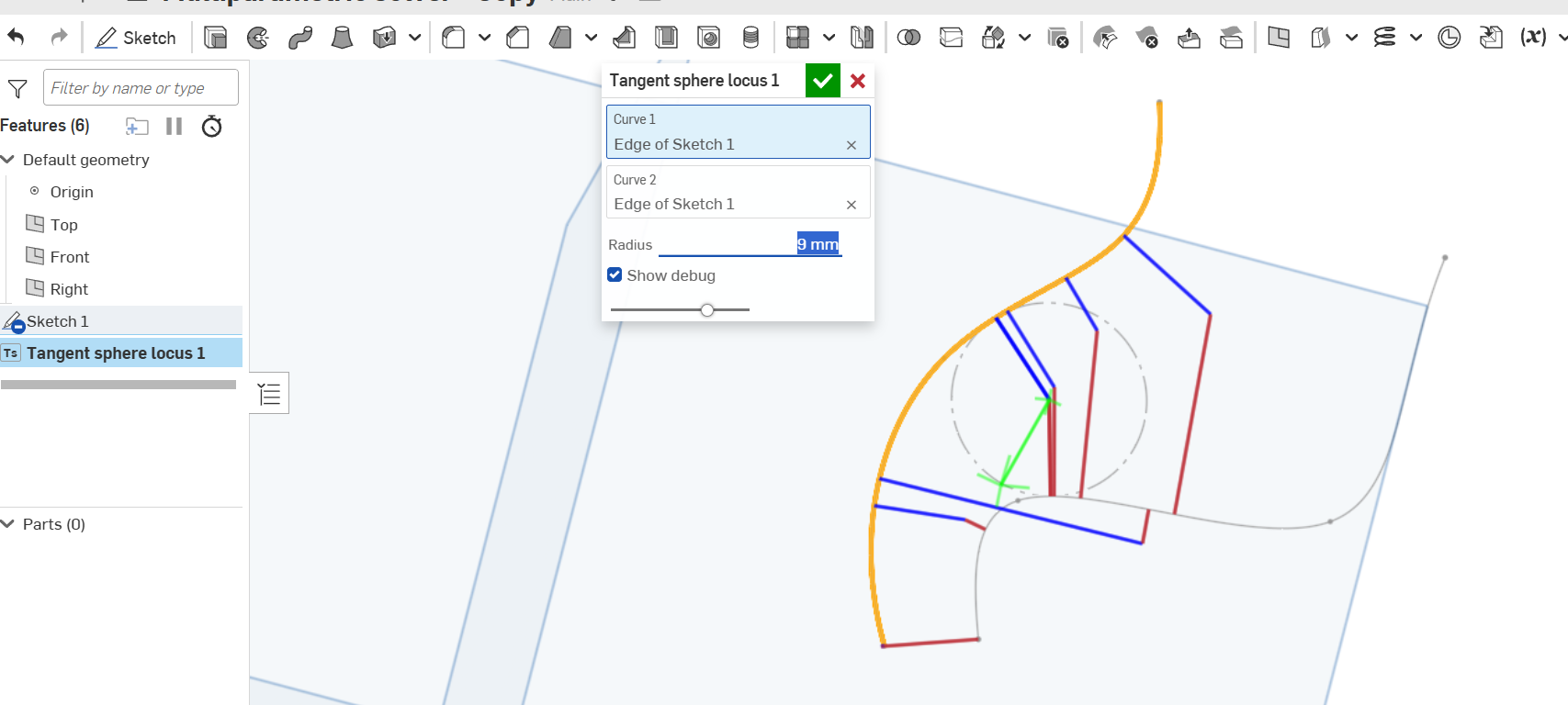

Re: Multiple Intersections with evDistance or ???
So thats how far I could go with numeric solver:
https://cad.onshape.com/documents/1b86ee796bef2029e6f14e05/w/c9553ae626e57286a7701cc2/e/87b602b735693a9eeba8668f
The solve function requires initial guess vector of curve path parameters, around which it should perform the search. However I noticed that it could jump around and in case of multiple possible solutions the one which it will choose is not well defined by initial condition of parameters vector. Its likely because I had to always take fractional part of path parameters on every iteration, because every next provided parameter vector from solver evaluation is not guarantied to fall between 0 and 1 - this is likely where the root to well behaving initial condition lies, if we could find good enough coercion from any number to path parameter, just taking fractional part is obviously too naive.
