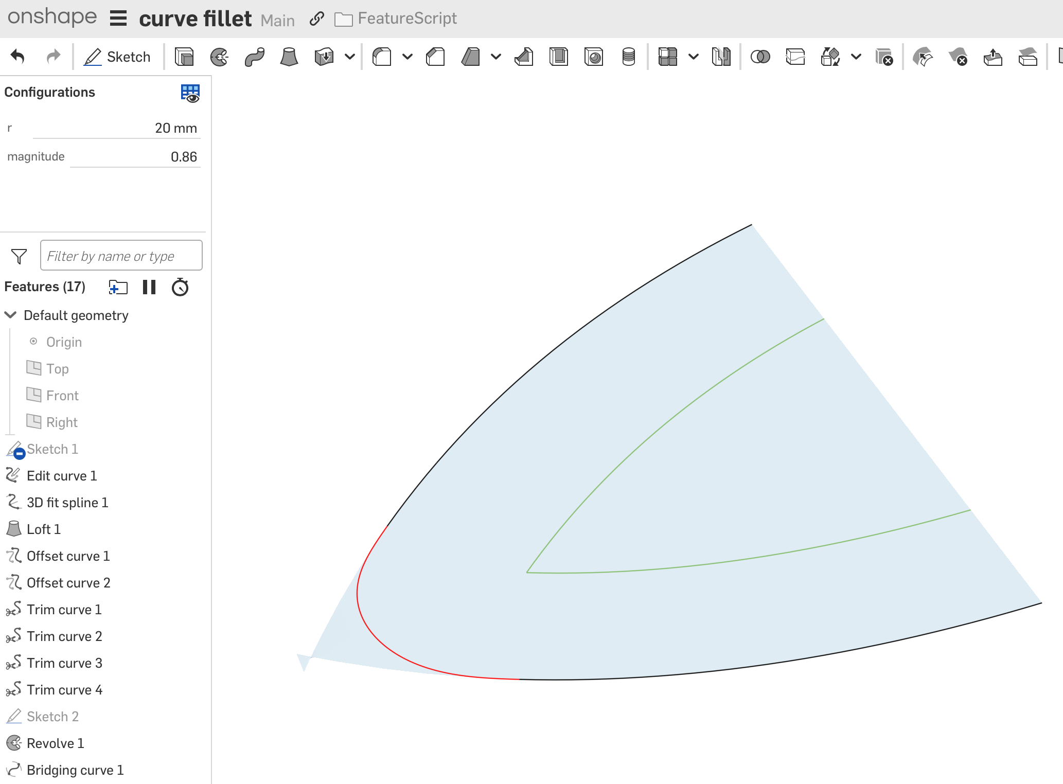

    Ultimately I want to be able to find the center of a virtual sphere (of a user selected radius) which is tangent to both curves. I'm focusing now on using offset curves (the 3D kind that are geodesic or euclidean on a surface) and then trimming those to each other. I'm lofting between the two inputs to get the reference surface, but if there are multiple intersections between the input curves, that's not going to work.
    Here's a screenshot of my feature based prototype (blue surface is lofted between input curves, green are offset curves which are trimmed to each other, black are trimmed using the ends of the green curves, and red is the bridging curve):

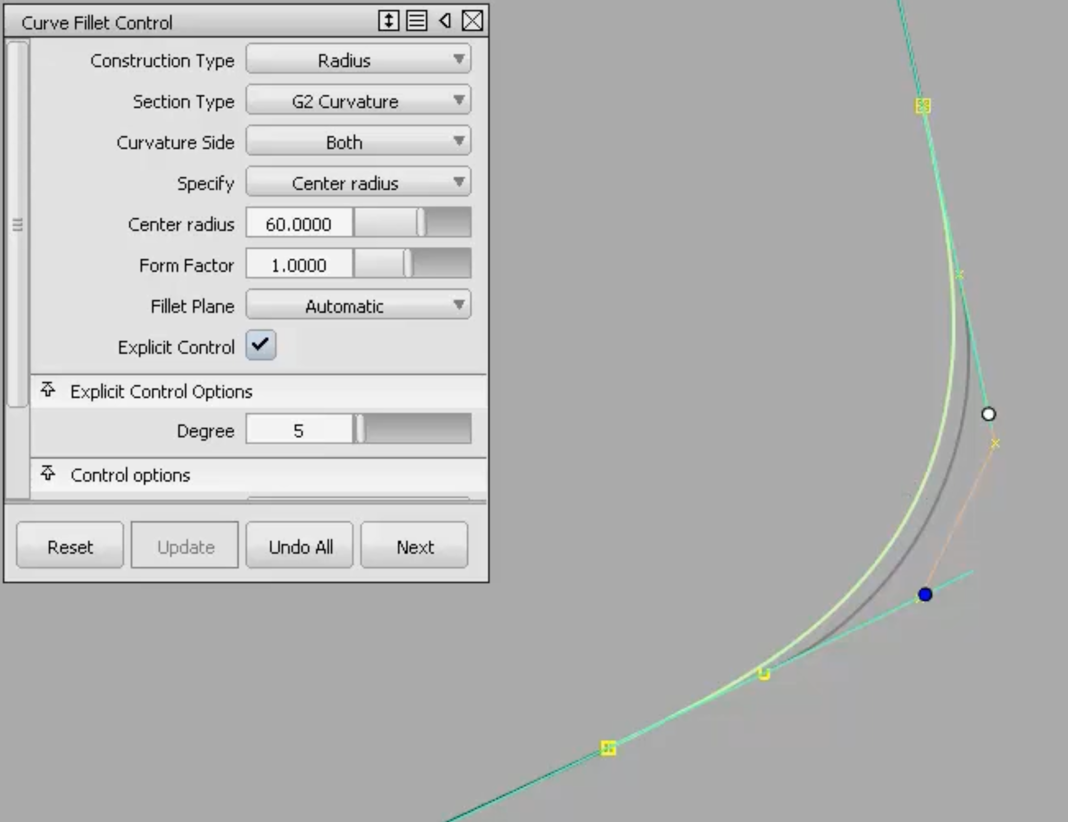

    The long term goal is to create something like Alias's Curve Fillet where the feature automatically trims the input curves, and has a few different ways to modify the shape symmetrically:
    https://help.autodesk.com/view/ALIAS/2026/ENU/?guid=GUID-5BBF940A-0255-4BC6-B081-A10DFC22317B
