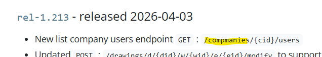

typo in the api changelog
API support for Ordinate dimensions!
