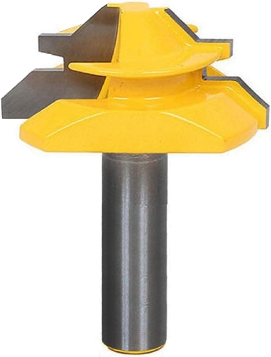

I can create miter corners easy enough, but I want to include the zigzag that this miter bit creates... https://smile.amazon.com/Meihejia-Degree-Router-Woodworking-Cutter-Tool/dp/B07BJHZKHQ/ref=sr_1_29?dchild=1&keywords=router+bit&qid=1618344223&sr=8-29
