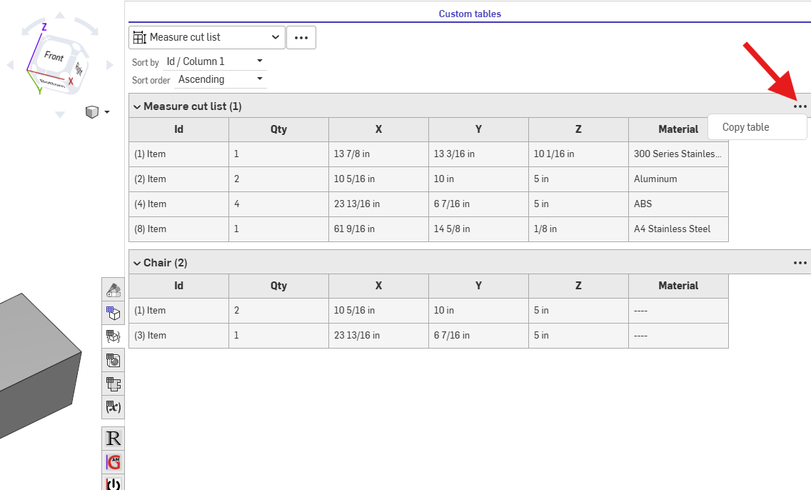

    @sacha_holsnyder for now, you can click on the 3 dots and "Copy table" this will let you paste it into excel or google sheets where you can export as csv.

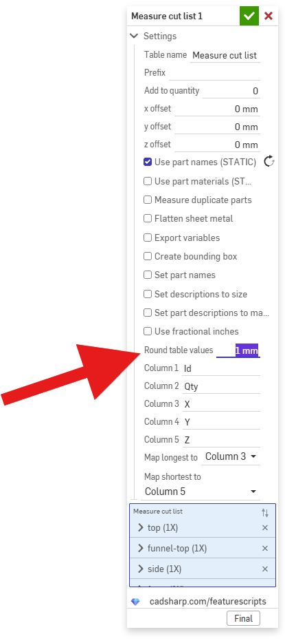

    @MichaelPascoe I love this feature. I do seem to get slightly incorrect figures in metric, e.g. 12.0 Z thickness becomes 11.989 in the table. Is it possible to set rounding? https://cad.onshape.com/documents/46579eb00df0aa76f85c4e84/w/56ada518491428db0b5e16cf/e/46dbe19100e1b9cb1176a77a
  • MichaelPascoe
    MichaelPascoe Member Posts: 2,956 PRO
    edited August 12
    @tom_19 while inside the feature, open up Settings, then input a very small value for the Round table values.
    Whatever you want it to round by, something like 0.001mm
