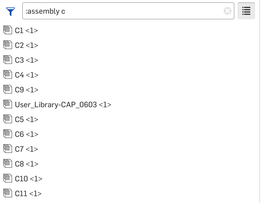

    In an assembly with multiple parts, e.g., 100+, it is sometimes impossible to track down the desired parts directly by looking at the instance list. A good example is an imported PCB assembly with multiple similarly named components/instances. Even filtering is not helpful in this scenario:
    In cases like these, selecting from the graphics area (to move into another assembly) is the only practical way.
    Thankfully, it can be done. As previously mentioned, the caveat is that selecting objects that do not qualify for "move into new subassembly" makes this option disappear from the right-mouse-button context menu.
    Therefore, my workaround is:
    1. Select the components in the graphics area. The corresponding entries in the instance list will be highlighted with a light blue shade.
    2. Select (explicitly, by clicking) the lightly-highlighted components in the instance list.
    3. (Important!) Unselect the selection in the graphics area by holding Ctrl while clicking.
    You will be now left with only the instance list selection, and you should see the "move into new subassembly" option available upon right-mouse-button clicking on any of the selected instances (in the instance list).
