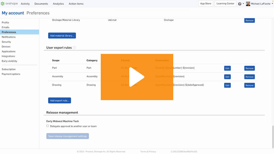

    I'm confused. Almost a year ago this improvement happened for things in zip files:
    4d6e3d4239f4fe70c6b2637264feb69458504505.jpg?image_play_button_size=2x&image_crop_resized=960x540&image_play_button_rounded=1&image_play_button_color=f88701e0
    Improvements to Onshape - April 28th, 2023 — Onshape
    Yet this thread is active and there are a bunch of improvement requests which haven't been marked complete.

    Is it possible you don't know about setting Export rules in your account preferences?

    This seems to be a problem still - I do not see the same UI that is shown in the improvements video - if I select multiple parts in a part studio or assembly studio, the first box in the dialog is NOT called "zip file name" it is just called "file name" so that right there says there is something wrong - I do not get an interface that looks like it knows it is creating a zip file.
