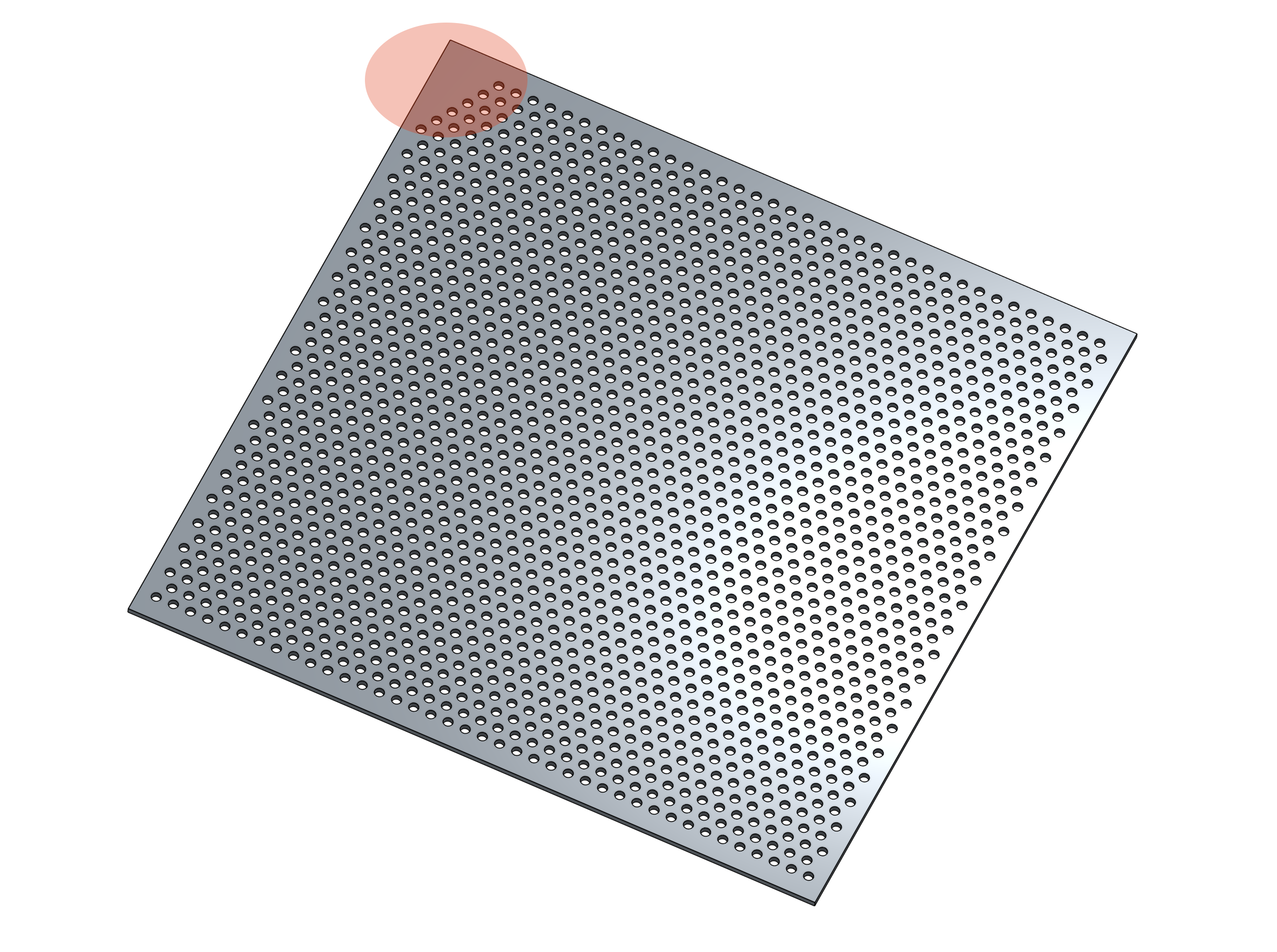

  • rteu_hitzker
    rteu_hitzker Member Posts: 1 PRO
    Nice Feature, we are using it in our designs. Now we have run into the problem that if the HEX pattern with 15mm is used, on a 600mm x 600mm face, in one corner the pattern is missing.
    I narrowed the issue down to the restriction of the instances here:
    if (definition.patternType == FillPatternType.HEX)
       // Hex pattern creates a parallelogram shape outside of the face
        // so removing excess instances in X direction for performance
        minX -= ceil(maxY / 3);
        maxX -= floor(minY / 3);
    If i replace both 3 with 2 then the pattern is complete.
    I do not know if 2 is the optimal value, but it solves the issue.
    Thanks
