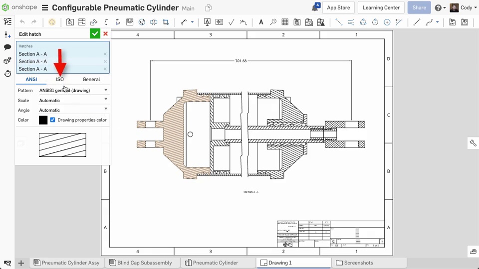

I see how Onshape can color a sketch region using the Offset Surface feature with Add Appearance. In a similar purpose to distinguish a sketch region, can Onshape "texture" a region to have it show as plywood, wood, or just crisscross, dots, or lines? I researched "Texture" in Onshape help without success. Thank you.
Not directly. You can extrude a bunch of parts, make an assembly, make a drawing with a cross section. Drawing cross sections can follow all kinds of patterns. You can also hatch faces without making a section view.
https://cad.onshape.com/help/Content/drawings-styles.htm#HatchStyleSimon Gatrall | Product Development, Engineering, Design, Onshape | Ex- IDEO, PCH, Unagi, Carbon | LinkedIn
