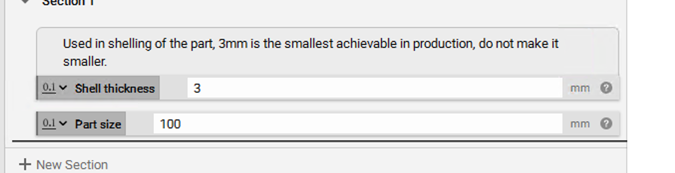

    This is a great feature! Around the same time I had the exact same idea, sadly I can’t share it. I did find writing the design intent into a custom table too was useful, meant the information was accessible in table form on the right hand side, with querys added to the custom tables they also cross-highlight.
    Totally agree a comment/design intent should be an optional field to all native features, akin to programming in-line comments. nTop actually has a neat way comments are added as balloons above the features/variables, see picture. I'm sure Onshape can put together something super polished, would be pretty on top of folders and all features alike in the feature three and assembly instance lists!
