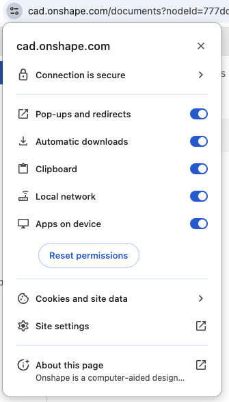

Clearly I use this everyday, but it seems to have stopped working with onshape specifically. I am using Firefox. It has always been a little annoying as i have to start the server and refresh the browser each time I close down the browser, which is frustrating. But it's now just stopped all together. Is anyone else experiencing this problem? I have raised it with support.

    I actually ran a new driver update from 3DC and it seems to have fixed it. I'm using Chrome, not firefox. Thanks, @S1mon . However still having to reboot the '3DxNLServer' each time I open up chrome. I know Onshape don't like fielding queries with this device, understandably. But it's an extension of my arm! Anyone CAD'ing all day needs one.

  • jelte_steur_info
    Would the chrome permissions have different requirements for wired vs bluetooth?
