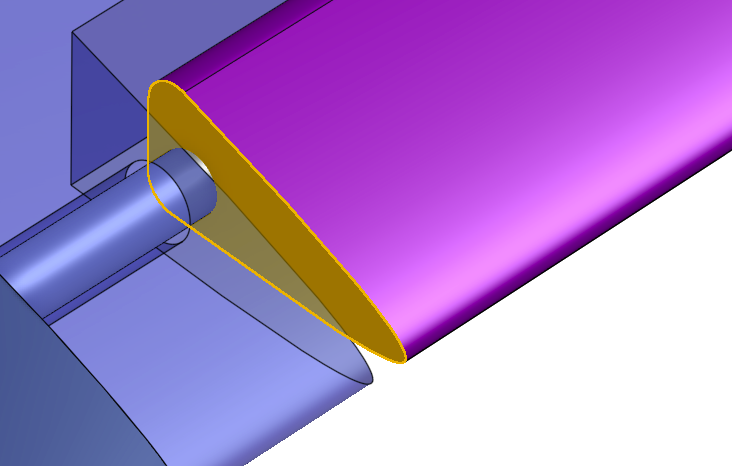

I am trying to design a remote control plane, and I have been at it for a while, but I have not found any dedicated tutorials for how to do such a thing in Onshape, so I would love if another set of eyes could look over it and give me pointers. This plane is designed to be a pusher UAV similar to small military surveilancsurveillance UAVs to operate with a small brushless engine. Thank you for checking it out!

    Pretty sweet design over all, nice work!
    Here are some things I noticed:
    • This fillet seems to be particularly bad. Try using blend face here instead.
    • 155 seems like a lot of features for how simple and clean the drone design is. I imagine you could do this in 60 features or less.
    • When taking a section view along the purple rods:
      • There is an interference with the wing and the wing rod.
      • The loose fit tolerance for the purple rods may be too loose. I usually use 0.005in for a loose fit that still allows for glue.
      • Where the purple rod meets the tail fin area, there are open gaps where the rod holder doesn't properly meet the tail fin.
    • The tail fin corners need some work, the curvature is bad there. Perhaps try a different method or use guide curves.
    • The right fin didn't get the boolean operation for the rod clearance.
