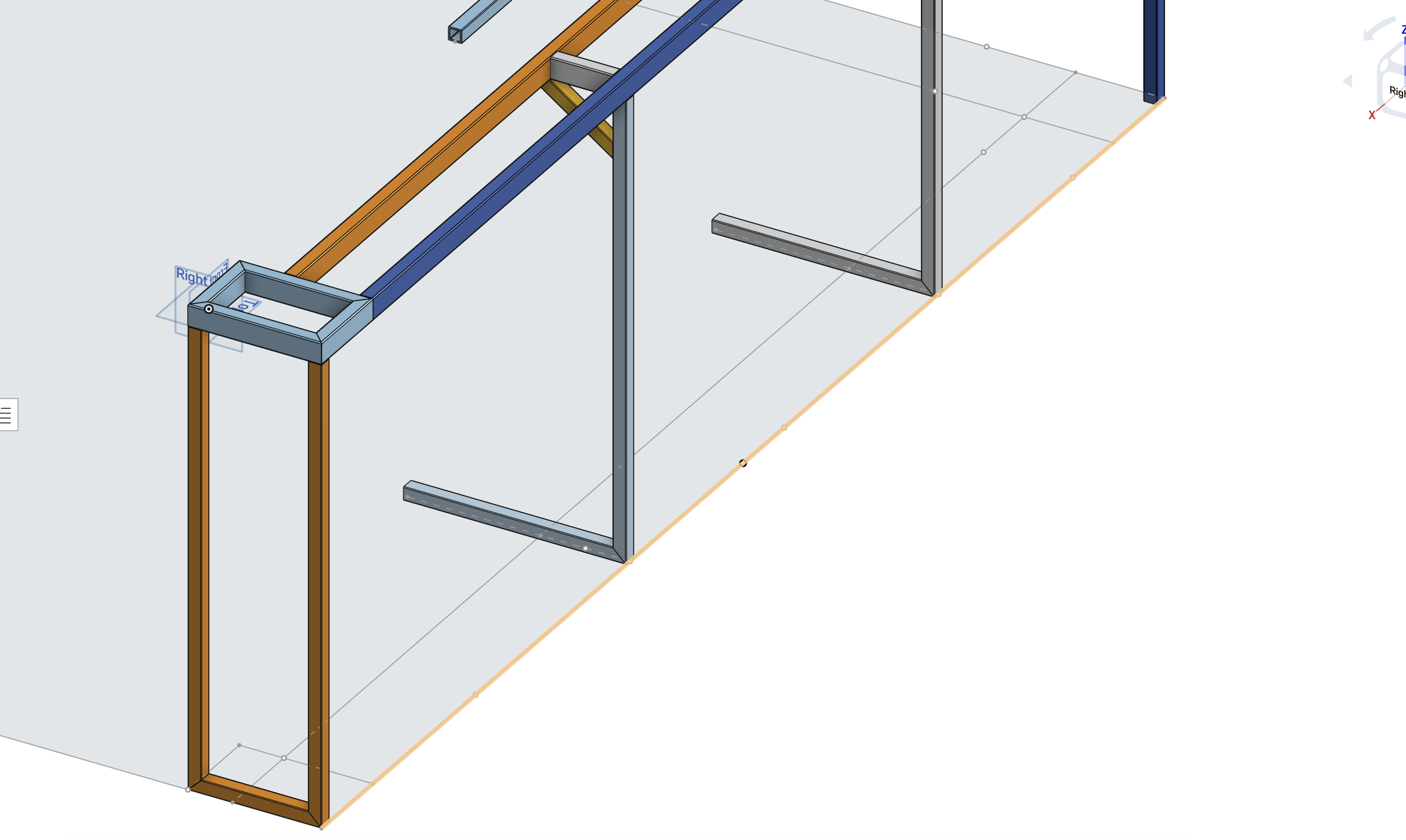

I like the idea, does not seem to work though. Though, that may be an issue w/ onshape.
Hi, could you please send me a link to your design. The screenshot by itself isn't showing what your problem is.
Awesome feature.
I'm not sure how easy or hard would be to implement a feature that could 'cut' multiple intersecting parts out of a frame. Sorry i'm new to this but I don't think there is a way currently to add a frame to the highlighted edge using a single frame feature?
I think the only way this could be done is if frame trim allowed for multiple faces to be selected, which currently it doesn't AFAIK. Seems like a useful feature to have though!
