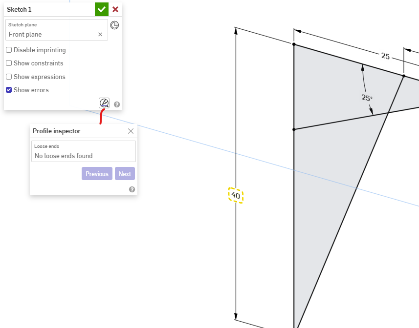

How to correct this notice: "sketch is not fully defined"?
unable to extrude on the original two dimention sketch
Unable to extrude on two D sketch. notice" sketch is not fully defined"?
You may want to start with the profile inspecter to make sure there is s closed area to extrude a solid.
