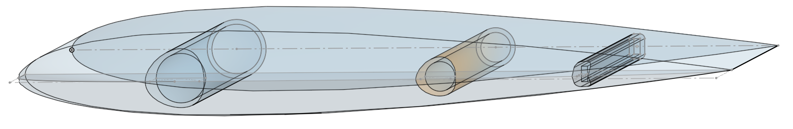

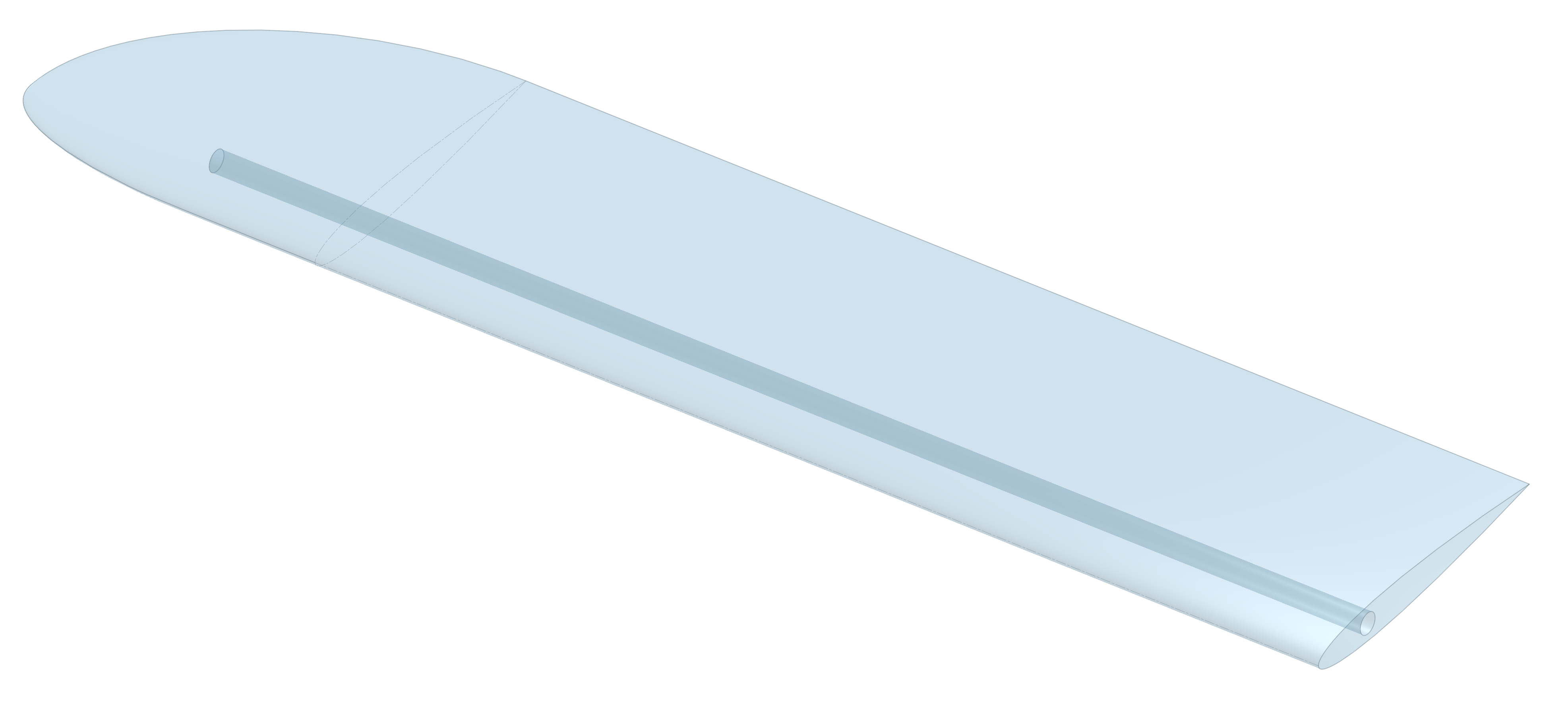

Hello all,
I am trying to make a leeboard hydrofoil model on this document: https://cad.onshape.com/documents/40a09d2b7dbc0e96f864de60/w/9b820e6caf97b342e0b34d33/e/e4addd4030400b4f4e982b63?renderMode=0&uiState=687bf140abce191eed0df80b

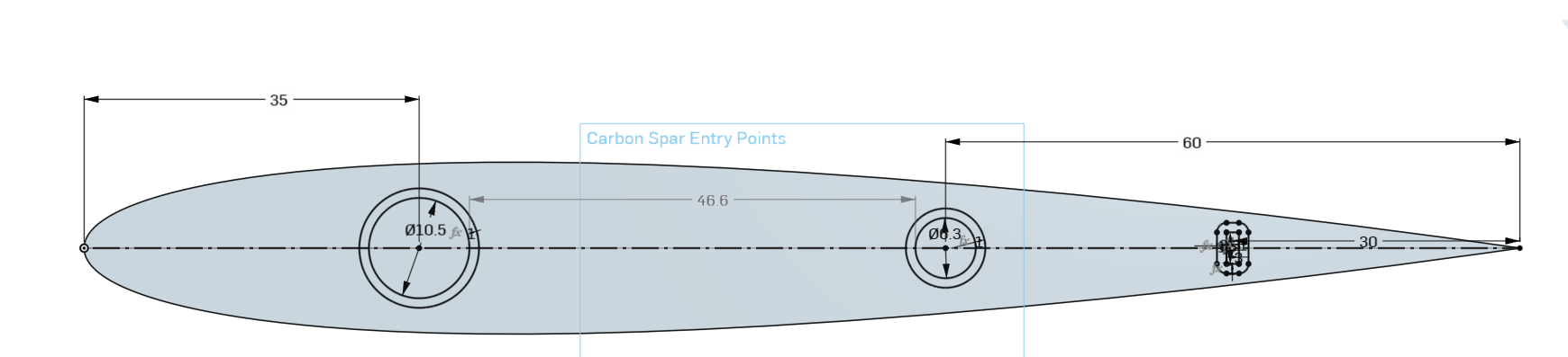

This will be 3D printed with carbon fibre spars inside it, and I have been struggling to make the holes for the carbon fibre spars. The basic idea is to use the sketch Carbon Spar Entry Points to make holes that will allow a carbon fibre spar to be entered into the hydrofoil.
Because the hydrofoil tapers at the end, the carbon spars cannot run the full length of the hydrofoil as they would be too thick to fit in the tapered area. So I want to make the hole for the carbon fibre spar stop with a flat bottom (which up to face/next does not give) before the walls around the carbon spar would get too thin.
When I say "too thin", I mean that I would not want any part of the spar to be within x mm of the outer shell in any axis (with the exception for the flat top of the hydrofoil where the spars will enter into it). For now, we'll say 2mm from the outer shell of the hydrofoil is the minimum wall thickness.
So far I have tried extrude remove with up to face/next and offset, the hole tool, move face and thicken - I know that some of these will be completely the wrong tool but I have just been playing to see what works. I'm sorry if this is an already answered question but Googling this has yielded no results probably because I'm not able to describe it in only a few words.
Thank you so much for any help!

    Hello @S1mon, thank you so much for your quick reply. I was able to come up with another solution inspired by your idea which required less workarounds for the difficult geometry of the foil profile.
    Thank you also for fixing the loft at the end by making it have a normal to profile end condition - I was not able to do this before but with your changes I was able to.
    I first tried to use the HAVF tool but this gave me slightly assymetrical foils which caused some issues. This could have been mitigated but I decided to keep with what I was already using.

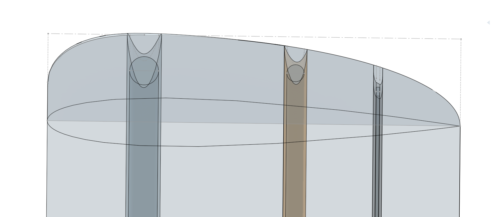

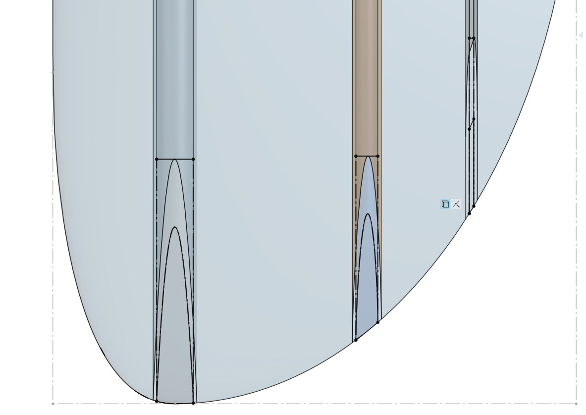

    Then I edited the Carbon Spar Entry Points sketch to add the minimum boundary around it in the sketch rather than making the minimum boundary in the End Loft. I extruded surfaces from each of these minimum boundary boxes that I made in the sketch and also make an extrusion in new mode for each of the spars like your document. I made the extrusions go Up to Next rather than up to the end vertex as this worked better for me. These are labelled Spar Template Tool and Spar Minimum Wall Template Tool.
    I then made a sketch on the chord plane of where the Spar Minimum Wall Template Tool intercepted the outer surface of the part. This sketch was labelled Spar Minimum Wall Thickness Intercept. I then did one split for each of the spars on the point of intersection. Then just a boolean subtract to make the spar holes.

    One challenge is that you're using the Profile Generator which creates very complex curves which are very hard to work with. I would highly recommend trying the HAVF feature:
    https://forum.onshape.com/discussion/24730/new-custom-feature-havf-profiles-standard-airfoil-profiles
    For now, I cleaned up the curve you created with Profile Generator using the Edit Curve Approximate function. Then I offset the tip surface (after trimming the tip and adding some radii to the front and rear so that the offsets would work). This allowed me to create a reference cut in a cylindrical tool which I used to trim its length and then I subtracted from the wing.
    There's a variable which controls the offset distance for the minimum wall. It will likely fail at some values because of the challenges of offsetting the wing surfaces.
    There's probably a bunch of ways to solve this, but hopefully this gives you some ideas.
