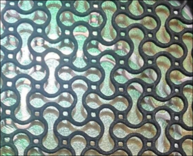

How can I pattern this particular shape as such:
john_spedding
john_spedding Member Posts: 2 ✭
I know how to draw the "figure eight" shape, but I don't really know how to get this to pattern in such a way as seen above. Any help would be much appreciated.

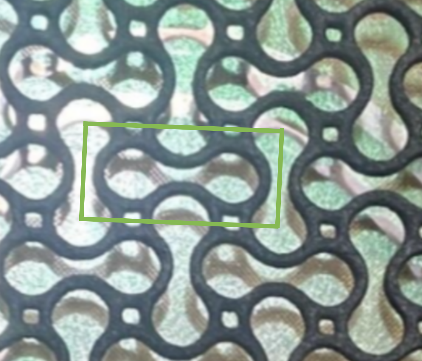

  • EvanReese
    Model just the smallest segment (like the green rectangle below) of it you can and use Linear Pattern.
