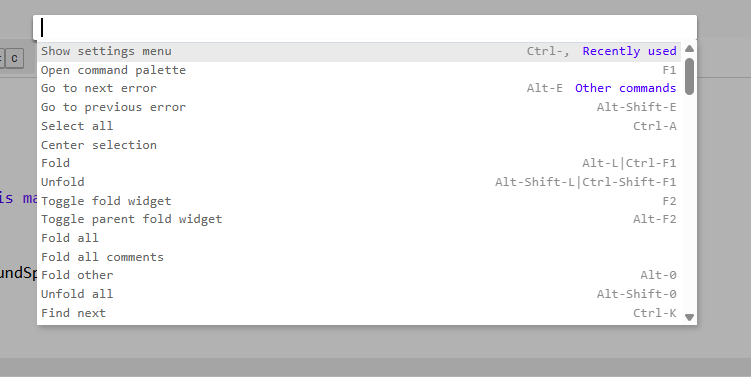

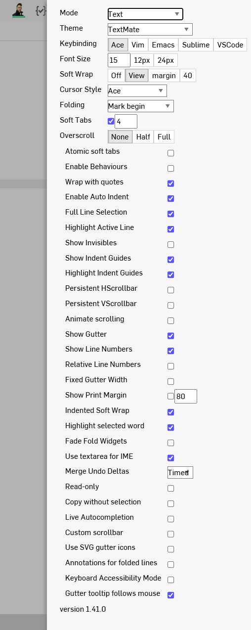

That while in FeatureStudio, you can press F1 to open up the FeatureScript IDE hotkeys where you can then access the IDE settings?
IDE Hotkey menu
IDE Settings Menu

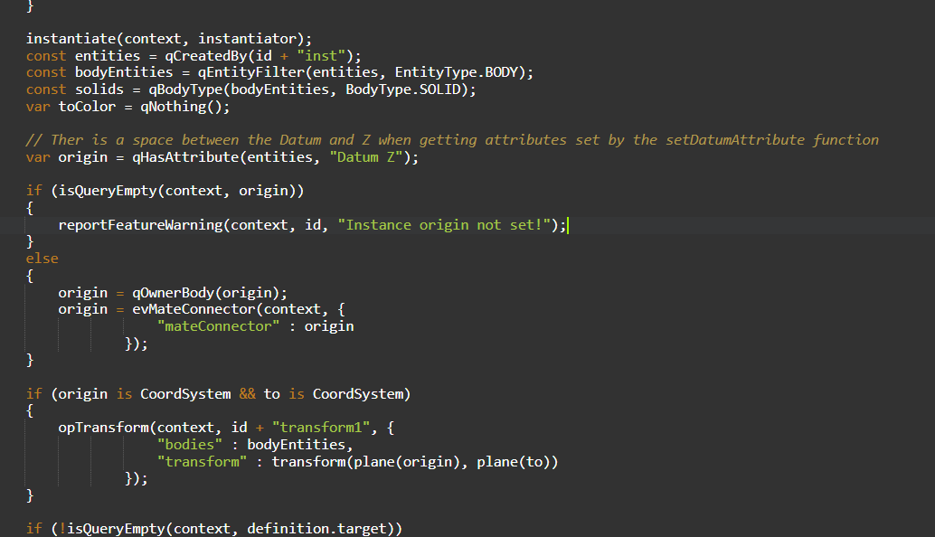

One of the IDE dark themes

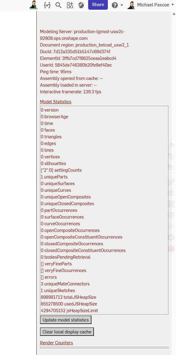

While in any studio, you can press CTRL + D to open the secret menu that shows statistics about your studio:

ooooooh! I'm going to try out the evil secret IDE menu. I DID know about the second one because it's often the solution when you have a weird rendering issue (like a face disappears and you don't know why). Click "clear local display cache" and shift+refresh.
