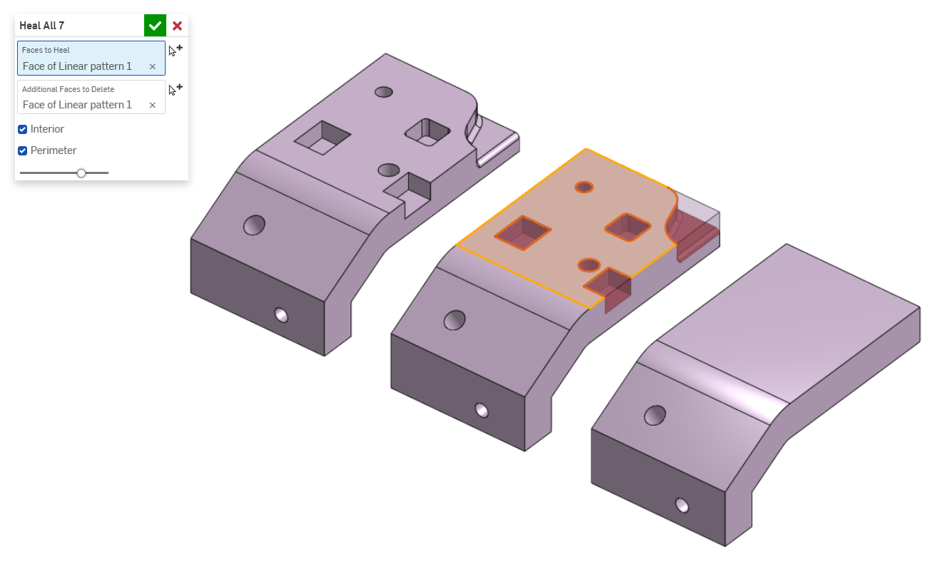

New Custom Feature: Heal All
joshtargo
edited August 2025 in FeatureScript
Applies Delete Face to all interior and/or perimeter voids. Excellent when working with imported parts.
Just finished writing, let me know if you have issues.

    I haven't actually tried this yet, but I'm wondering how this is different from @GregBrown 's Extract feature?
    [edit - nevermind, this isn't for surfaces, it's for parts. That's magical. Might be good to make the examples look more like thicker parts.]

    EDIT: modified the code to handle more complex "defects"
    I can do that, though I had imagined using it more for sheet goods like metal and lexan. never even thought to try on more volumetric stuff.. I may need to add code to pick up the bottom of pockets that don't go all the way through, or counterbore holes, etc.

    Good job. I hoped that it would work to remove gear teeth or splines and leave the gear blank but it doesn't do that because there are not one intact surface of the gear blank and selecting all of the gear tips (which are the surface of the blank that is left) also doesn't remove it, so the best way is still to select all of the cut faces individually for a delete face feature.
  • joshtargo
    edited August 2025
    send me a link so i can see if i can do a fix. or make a pattern selection for each tooth side and then run?
