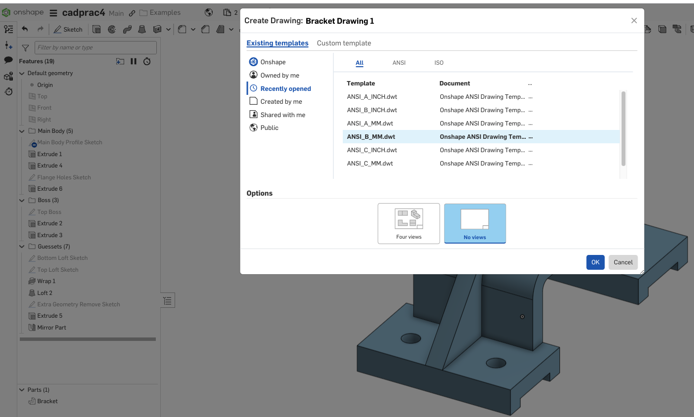

    An 11x17 size drawing is equivalent to a ANSI-B size…(no custom size definition needed) . When creating your drawing choose ANSI_B_MM.dwt template.

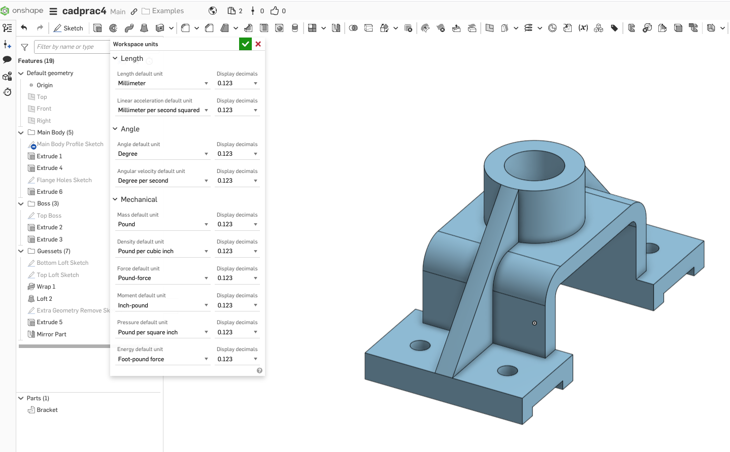

    Here is an example of a model the uses MM as it's Workspace units…

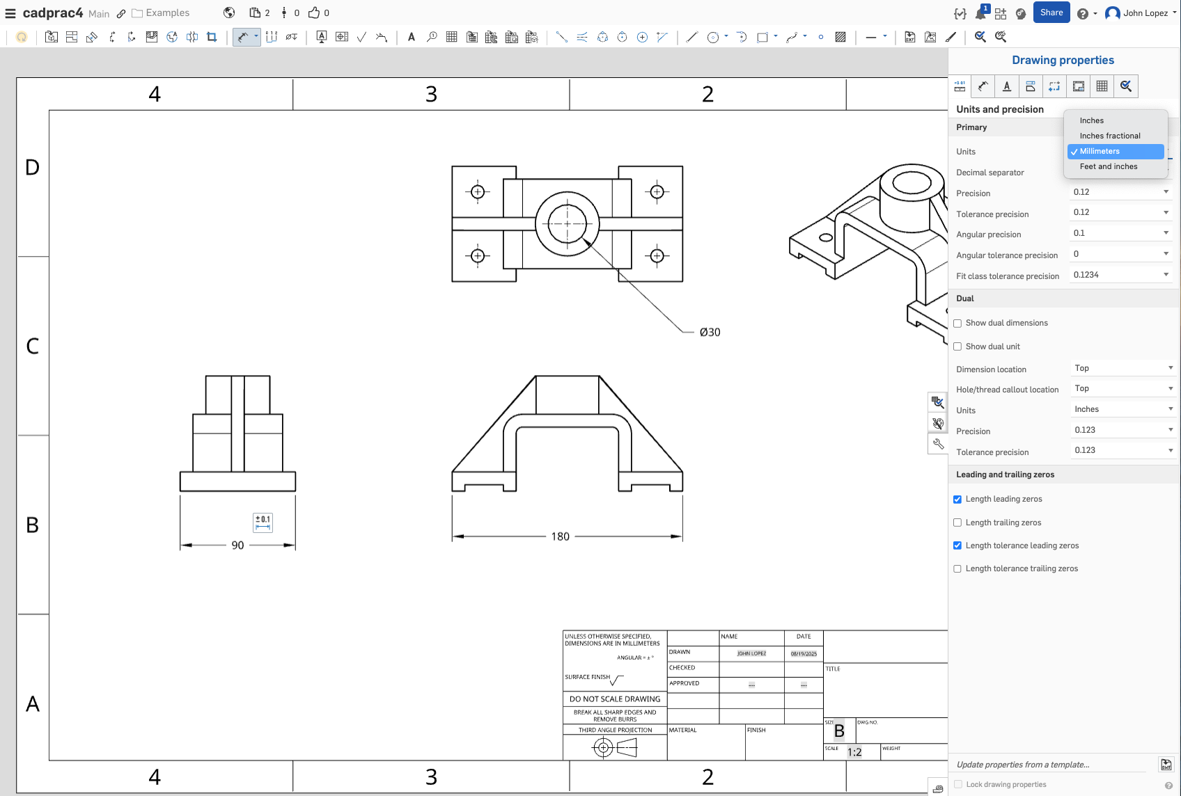

    …and here is the drawing created using a B size template…but with ISO dimensions.
