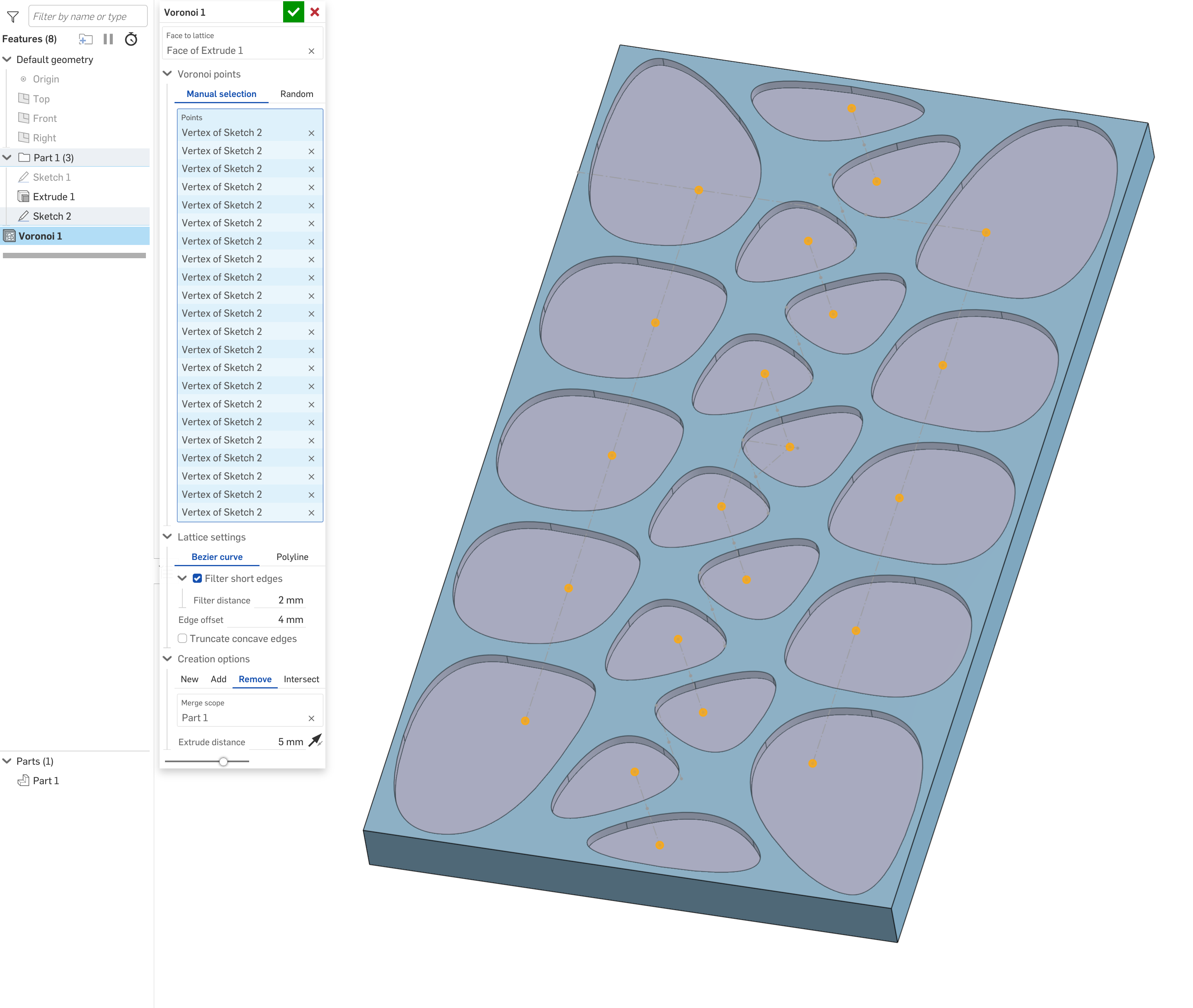

The only required input for the FeatureScript is a flat face or sketch surface, everything else is optional. On that face, it creates a Voronoi lattice, an organic-looking structure you’ll recognize from patterns in nature, biology, physics, architecture, and even consumer product design.

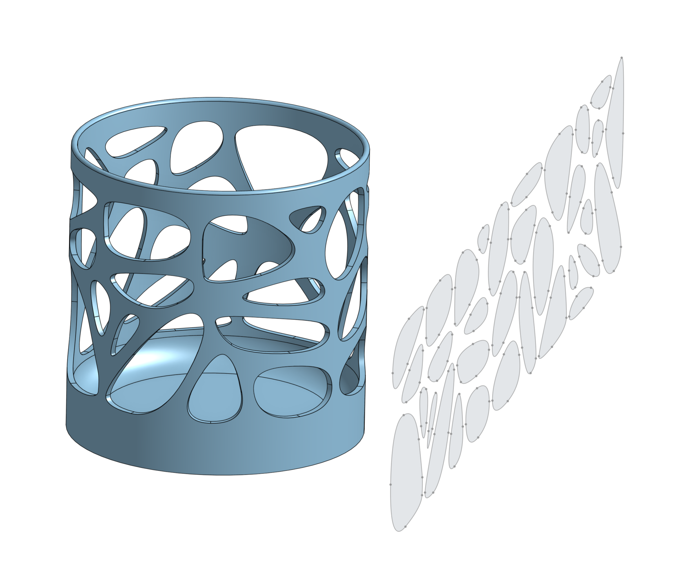

To demonstrate usage, I’ve included examples showing how the flat-face limitation can be worked around using wrap features, though I’m sure the community will find other creative ways to apply it. A version that works directly on more complex surfaces may come later. Screenshot 2025-08-18 at 20.45.44.png
Key Features
  • User-selected or pseudo-random Voronoi points (with seed input)
  • Choice between bezier-curve or polyline cells

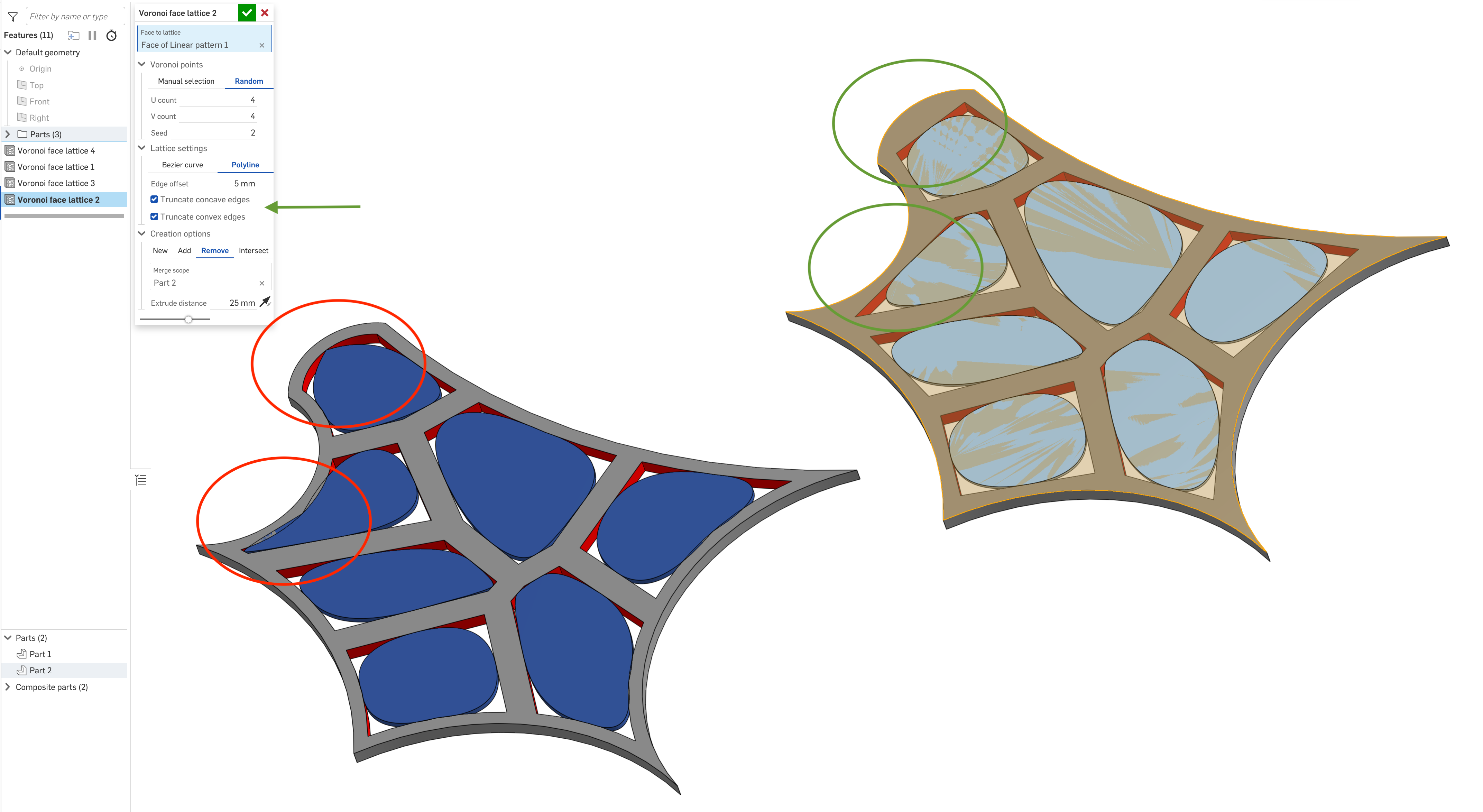

  • Option to truncate circular concave/convex edges for cleaner bezier outputs
  • Cell offset control for wall thickness
  • Short-edge filtering to avoid overly sharp bezier artifacts
  • Option to output only 2D geometry (useful for wraps or other downstream features)
  • Blind extrude with boolean and composite part options
Known Limitations / Future improvements
  • Currently works only on flat faces and sketch surfaces, option for general surface would be nice
  • Polyline output limited to 2D surfaces (sketch option disabled for now)
  • Extrude is blind-only (future: up-to, two-sided, etc.)
  • Editing logic function addition to pre-select the extrude direction upon creation would be nice.
  • Truncation could be extended to non-circular curves
  • Short-edge filter can misbehave if set too high
  • Large offsets may break the feature (error handling would help)
See it here: Voronoi face lattice.
