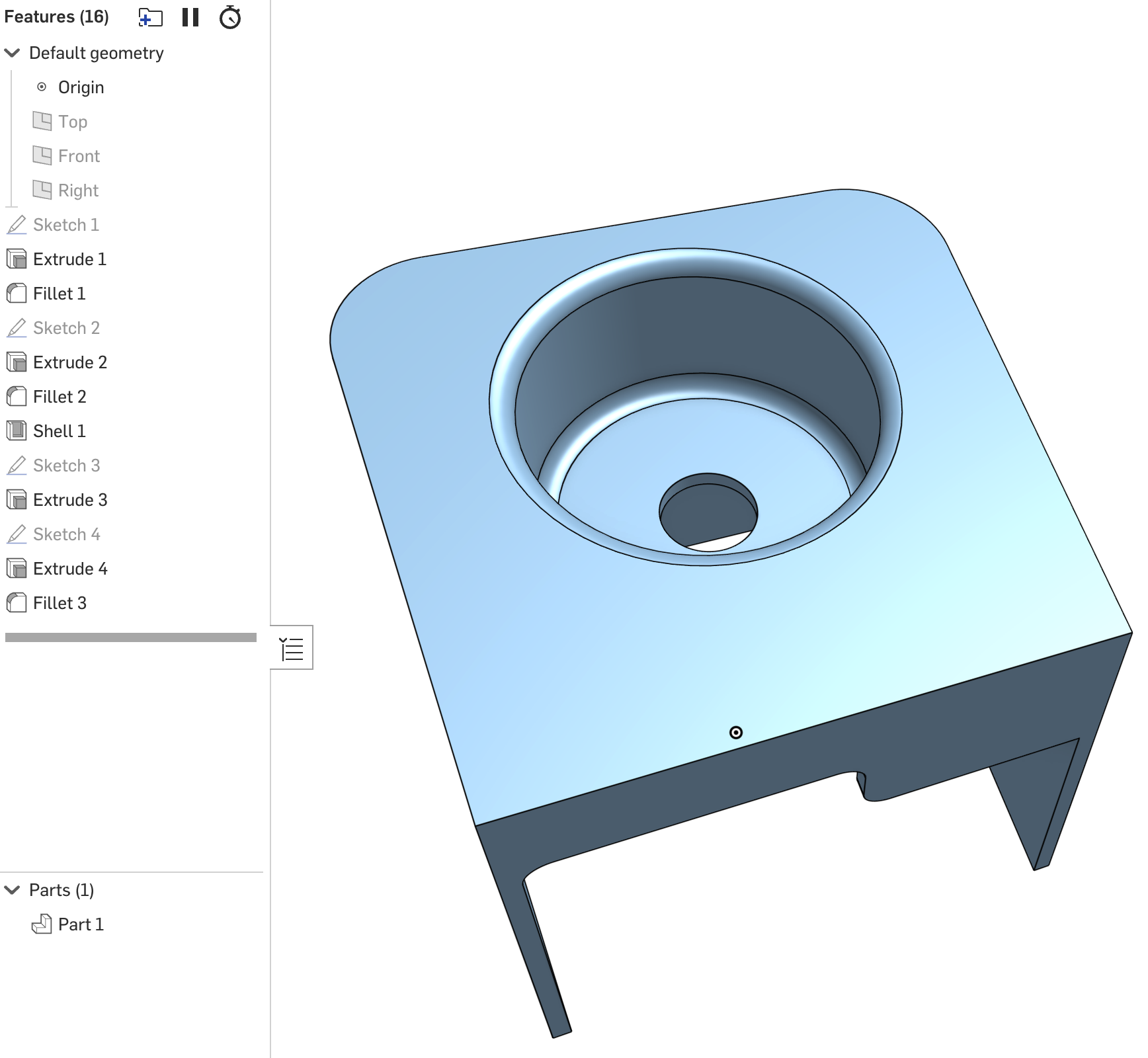

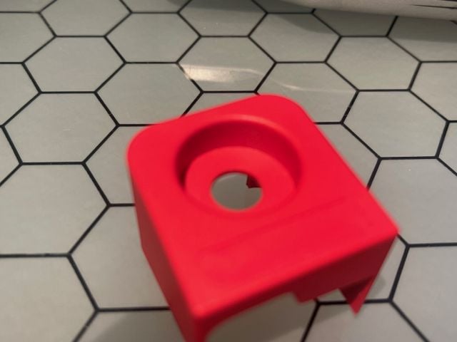

I'm quite newbe to Onshape, I'd like to create a moel to this object:

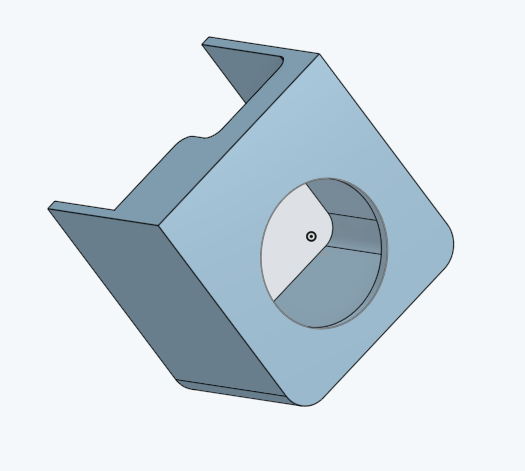

But I haven't an idea to create this recessed hole. My model looks like this right now:
Help me please!
  • Matt_Shields
    Matt_Shields Member, Onshape Employees Posts: 1,000 PRO
    You've got a few options. You could revolve the recessed hole into the current geometry. Did you use a shell? If so, just extrude a remove before the shell.
