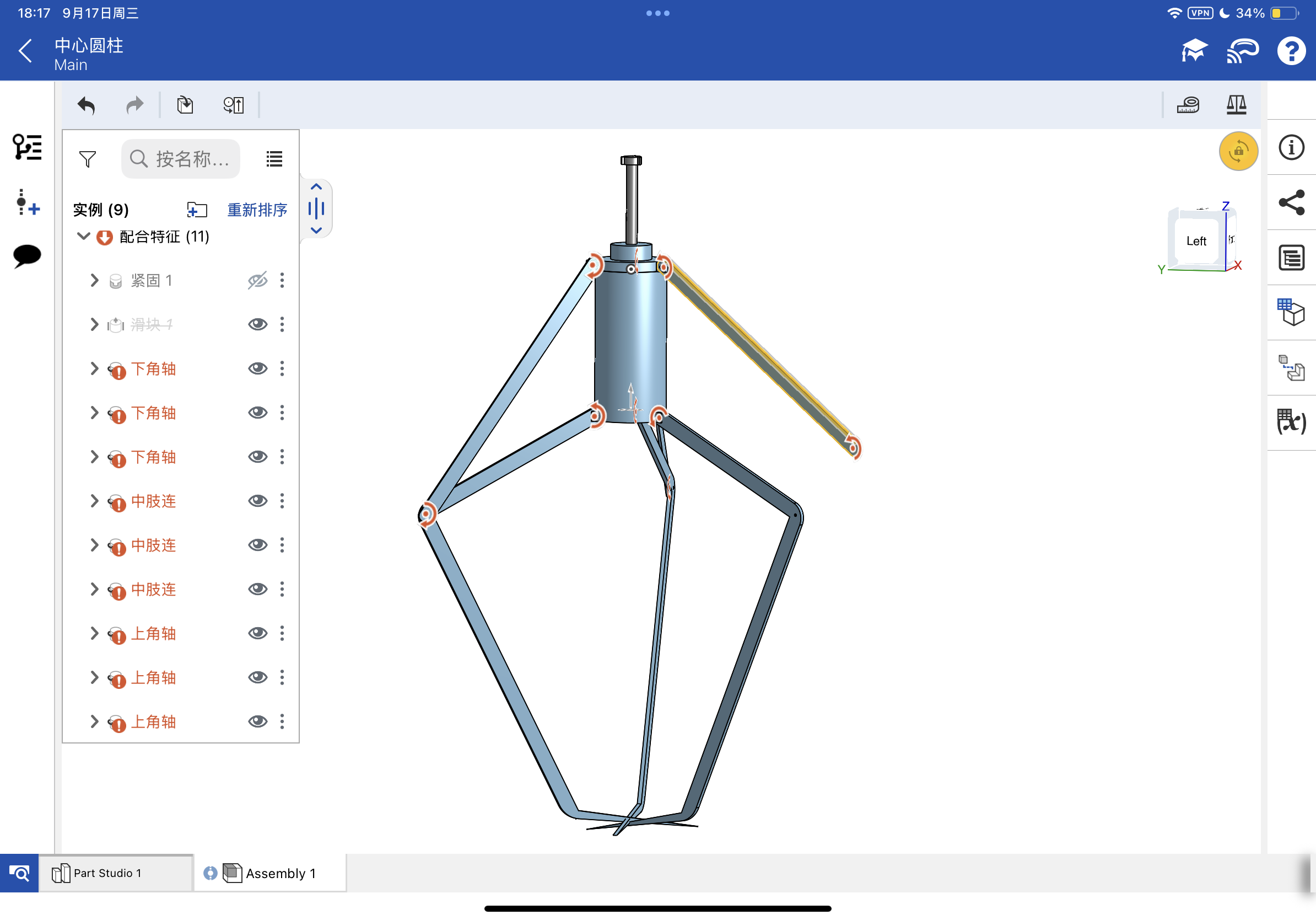

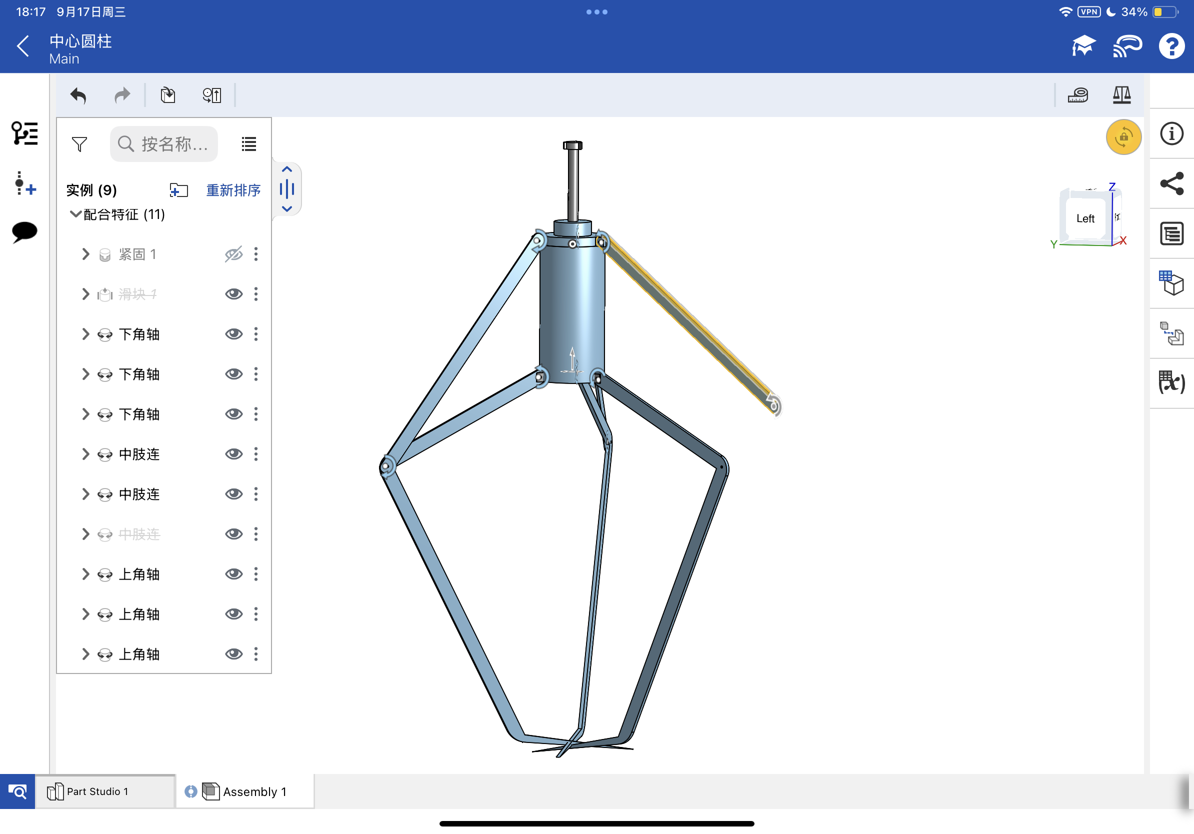

Why are all parts suddenly reporting errors about over-definition?
This is a mechanical grip that uses rotary lamination.
  • Matt_Shields
    Matt_Shields Member, Onshape Employees Posts: 1,000 PRO
    If you share your document, someone can probably take a look. Revolute mates need to line up exactly. Change a few to cylindrical and that might show you where you are off.
