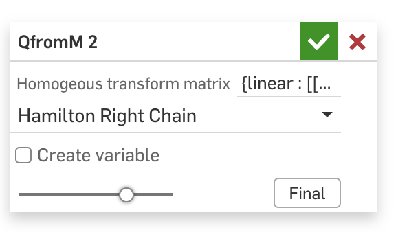

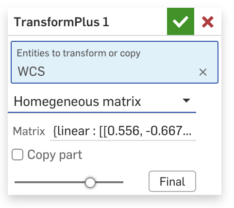

    As @jnewth points out, additional tools for transformations in quaternion form are good opportunities for custom features. I have my own set of Matrix to Quaternion and a hotrodded Transform feature that takes, amongst other things, a homogeneous transform matrix as inputs. This is pretty niche!
    The Euler to MC feature is much more aligned with observed robotics workflows since a) many robots use Euler angle-based inputs, and b) different robot manufacturers use different Tait-Bryan or Proper Euler approaches. There is also an option to save rotation matrix as variable which is the gateway to these even more niche tools I described. It is simple to, in Onshape's Variable table, to construct a full transform object partly based on the variable created in the Euler to MC feature….
